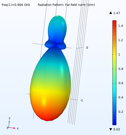

I'm trying to design a circular phased array which features a directional pattern at vacuum and I'm trying to make it work in a closed concrete room at 866 MHz of frequency and 2 W of output power; those cannot change.

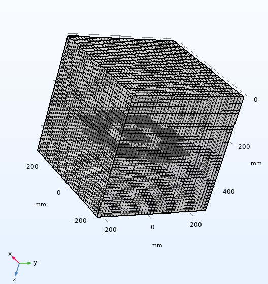

I set the scattering boundary condition on the walls and defined a quad mesh on the boundaries.
I want to measure the electric field at different heights inside the room, taking into account all the rebounds on the walls

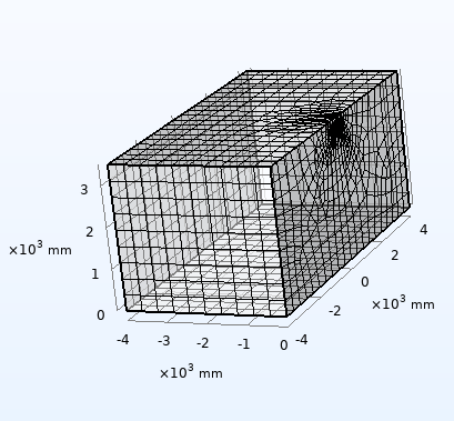

  • The last execution took more than seven hours to complete with the maximum recommended mesh element size of and a 500 mm x 500 mm x 500 mm room. The original size is 8 m x 8 m x 3.5 m, and takes even longer, supposing there's not a memory overflow. Is there a way to speed up the computation locally (e.g. parallelization), and how should I configure it?

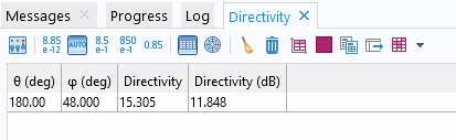

  • What does phi parameter mean in the directivity slide if there is a revolution far-field pattern?
I attach the .mph file and some pictures showing the mesh and the solutions not included for size issues. Thank you so much for your time in advance!

I just took a brief look. Hmm. I would attack this problem somewhat differently, but I'll offer you a couple really quick & easy suggestions for now: (1) you have a symmetry in the x=0 plane, right? So I suggest you take advantage of it to cut your problem space in half there (with a PMC boundary condition on the symmetry plane). (2) Also, go to the Settings section, Discretization, and replace Quadratic by Linear. This will enormously reduce your memory requirements and will also increase the speed of the computation. I suggest you do those things first, then let us all know how much that helps and if you still want to discuss other possible issues in your model! Added: I just noticed that you've got all your elements driven together, as if they were acting in unity, as one single port. But there is insufficient symmetry to cause them to truly act identically, so it seems to me you are attempting to enforce an inappropriate boundary condition on those ports? If I were preparing the model, I would specify a separate port for each element. This change certainly can't hurt, and it just might help. Also, I think you might want to use a finer mesh in/on the antenna elements themselves. But... one step at a time, I suppose.
I just took a brief look. Hmm. I would attack this problem somewhat differently, but I'll offer you a couple *really quick & easy* suggestions for now: (1) you have a symmetry in the x=0 plane, right? So I suggest you take advantage of it to cut your problem space in half there (with a PMC boundary condition on the symmetry plane). (2) Also, go to the Settings section, Discretization, and replace Quadratic by Linear. This will *enormously* reduce your memory requirements and will also increase the speed of the computation. I suggest you do those things first, then let us all know how much that helps and if you still want to discuss other possible issues in your model! Added: I just noticed that you've got all your elements driven together, as if they were acting in unity, as one single port. But there is insufficient symmetry to cause them to truly *act* identically, so it seems to me you are attempting to enforce an inappropriate boundary condition on those ports? If I were preparing the model, I would specify a separate port for each element. This change certainly can't hurt, and it just might help. Also, I think you might want to use a finer mesh in/on the antenna elements themselves. But... one step at a time, I suppose.

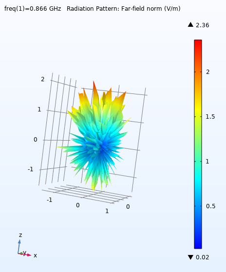

Firstly, my far field pattern was kind of distroyed, as I no longer have a directional pattern, but a ball with spikes, I don't know up to what point is that important.

  2. One reason a radiation pattern may be spikey is that you don't have enough points in your far field plot. But in your case, also:
  3. Your cell sizes in the radiated field region are far too large. Don't make any cell bigger than roughly lambda/6. Your cell sizes in the radiation volume are ~ lambda??! If so, that will surely generate nonsensical results for computed radiation patterns. Consider modeling a smaller test volume and use an appropriate max mesh size. Only after you get that to work well, and you get all the bugs out of it, then consider increasing your model size.
  4. One more thing. Your far-field aperture integration computation is also specified incorrectly. Now that you have the PMC symmetry plane present, you must tell the far field computing algorithm that there is a symmetry plane present, and what kind of symmetry to apply. In the Model Builder, go to: Electromagnetic Waves, Frequency Domain, then click on Far-Field Domain 1, then click on Far Field Calculation 1. Now, in Settings, expand the Far-Field Calculation item, and click the checkbox "Symmetry in the x=0 plane". The symmetry type: should show "Symmetry in E (PMC)". (If it shows something else, change it to that one.)

Ok, I made it finally with a lambda/3 size after five hours
Lambda/6 overflows my memory.
