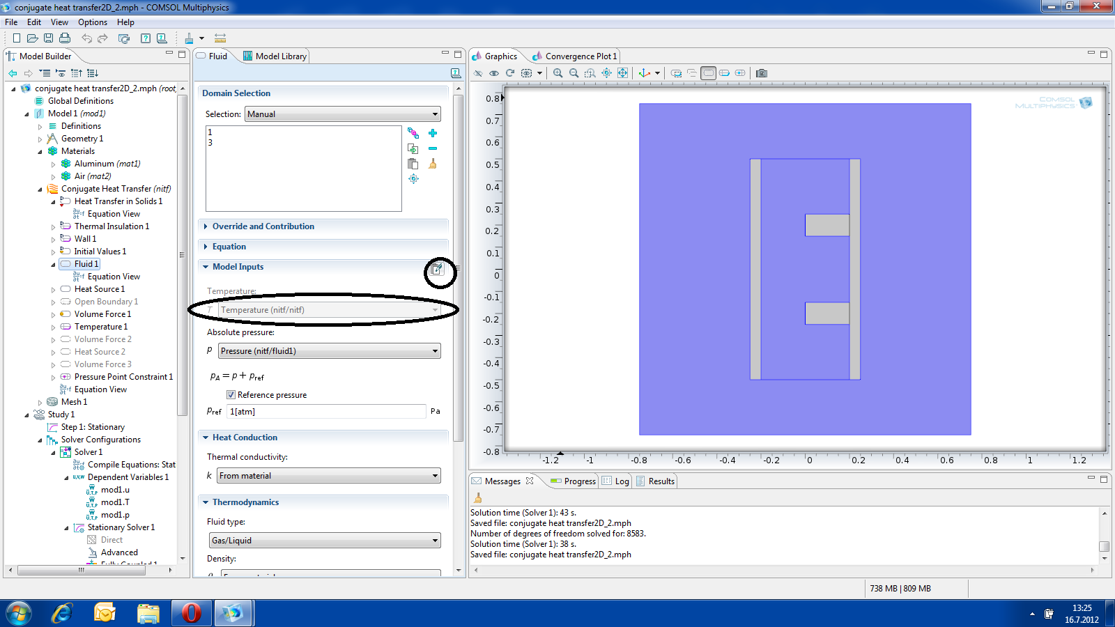

Here are fixed versions. Now both are giving similar results. I changed in Conjugate Heat Transfer => Fluid1 => Model Inputs => "Make All Model Inputs Editable" section off (check picture) and after this both are giving similar results. There are also other changes but I this was making biggest difference.
I prefer to use Non-Isotermal Flow.
