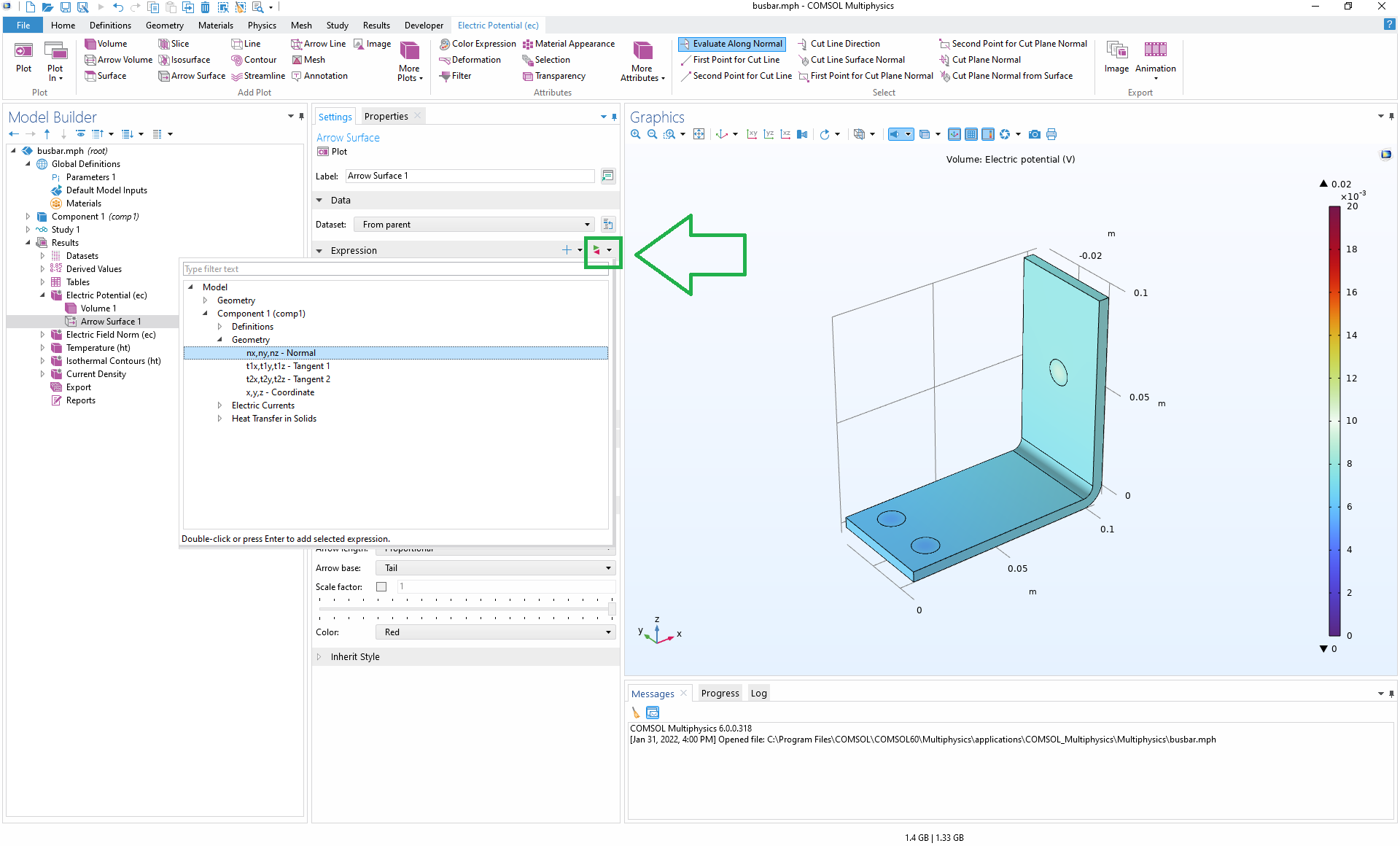

Nowadays, another very effective way of finding the name of predefined quantities is to, in the GUI itself, look at the postprocessing quantities available for plotting. See my attached screenshot: by pretending I want to generate an arrow plot on a geometry's surfaces, I can quickly determine that the normal vector is (nx, ny, nz).

Thank you. I did try to find them under the expression drop-down windows. However I was looking at the wrong catogory.
I used "surface" node under "dataset" node to define a surface and then used " surface integration" under the "derived values" node to compute the volume velocity (Hopefully, this is a correct way.)
When I click the replace expression icon, there is a "geometry" catagory that is at the same level with "component1". There is no "nx, ny, nz" under this catagory. So here comes another question: what is the difference between "geometry" and "component1"=>"geometry"?

Edit: I inquired with some colleagues, and we agreed that there is no fundamental reason for the existence of this Geometry category located outside of the Component category. It would be more logical for all the geometric quantities relevant to component 1 it to be found under Component. You can consider it a minor bug. I have reported it for correction. Thanks for pointing this out!
