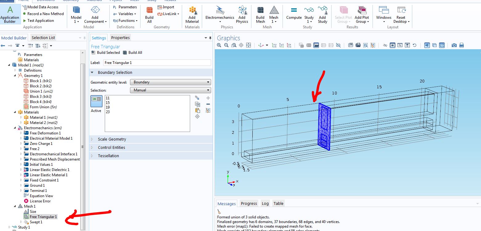

Hi Mr Ivar
I am simulating a electromechanics model with a beam covered by an air domain. I want to define the mesh by myself and I meet the same problem as presented one in this post.
I follow your steps :
1. add Convert node in Mesh, chose all boundaries of domain 2, 3, 4 ,5
2. add Free Triangular node, build it with "Remain" option.
Is it correct ?

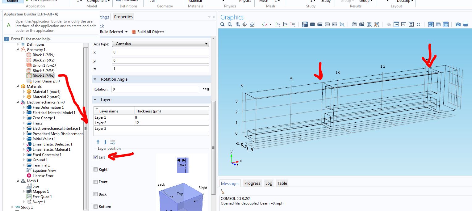

if you want to Sweep mesh through a set of domains, you need to add internal boundaries to make the geometry look like a cubic drawing. In your case it's rather simple, on Block4 add two Layers (only to the LEFT) of respectively 8 and then 12 um, this cut the last block in plane with the internal items. In this way you can mesh the full cut surface (chose at 8 um from the left inside the block, and then sweep out
That should make the trick.
With sweep mesh the initial surface you have meshed need to be swept WITHOUT change all through the domain.
I'm using triangular mesh, it's simpler and faster, if you want Quads you must work a bit more in manually defining the distributions along the edges

Dear Mr Ivar
Thank you very much. I see your idea.
Dear Mr Ivar
