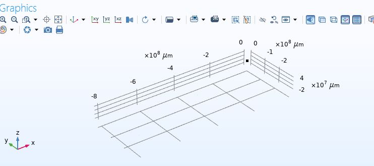

                                                    You may have a small object somewhere away from your main geometry? You should upload if possible.

I am trying to import a 3D porous structure in .stl format however since it was obtained with uCT analysis I am struggling to do so. Mainly because COMSOL does not build the imported file due to mesh issues. I tried to partition it multiple times with different settings but failed to do so. Perhaps it is due to that where I have objects far away.
