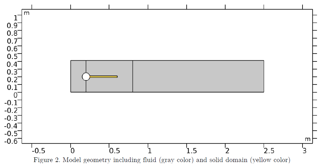

Hi Comsol Community, I am trying to use Comsol for simulating fluid flow around a cylinder with a flexible splitter plate (plz refer attached figure) and I want to use a structured mesh. What I tried until now is to use the Mapped mesh feature. I divided my Geometry in different domains. Meshing the areas away from the cylinder with a structured mesh is no problem. But I am not able to mesh that the area around the cylinder and splitter plate properly with the Mapped Mesh tool. Plz provied any suggestions regarding how to generated structured mesh around the cylinder and splitter plate?
