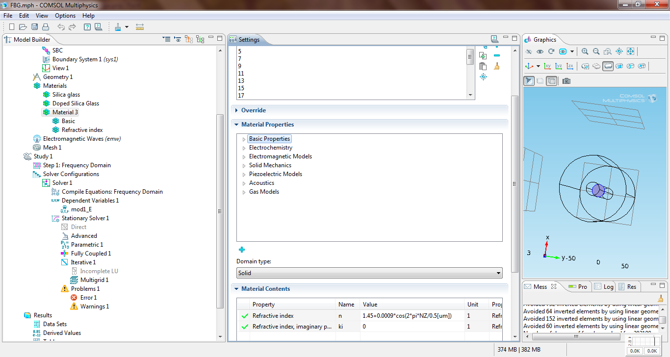

Im working in comsol v4.2. In my work, I want to assign a variable 'nz' that is dependant upon the variable 'z',for the value of z from 0 to 0.5 um. and want to use this varying 'nz' in material property. Is it possible to do?or how to do?

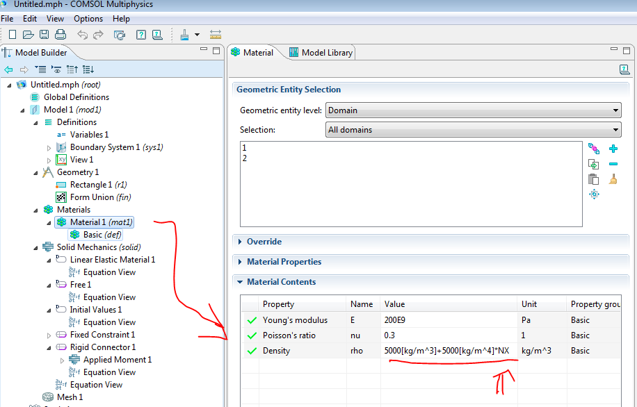

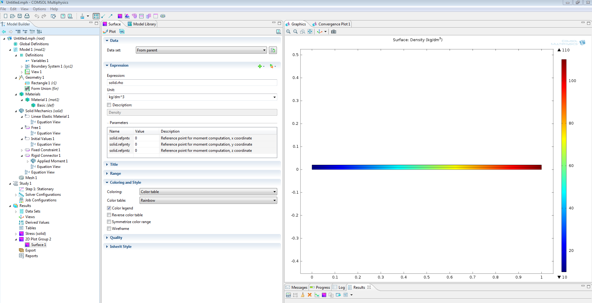

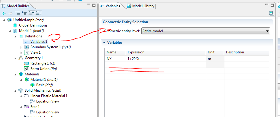

Is it this you want ?, I', using X in 2D X,Y but it could also be in Z in 3D. Note in solid x and X are different, use rather upper-case in Solids as this reefers to the actual geometrical position (material frame)
Hi Is it this you want ?, I', using X in 2D X,Y but it could also be in Z in 3D. Note in solid x and X are different, use rather upper-case in Solids as this reefers to the actual geometrical position (material frame) -- Good luck Ivar

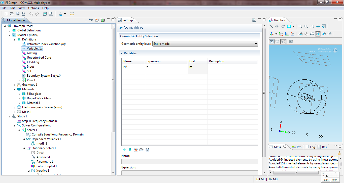

I tried 'Z' as the geometric frame but it says circular variable dependency detected. What can i do?
In my problem, 'Nz' should vary across the Z axis.
I tried 'Z' as the geometric frame but it says circular variable dependency detected. What can i do? In my problem, 'Nz' should vary across the Z axis.

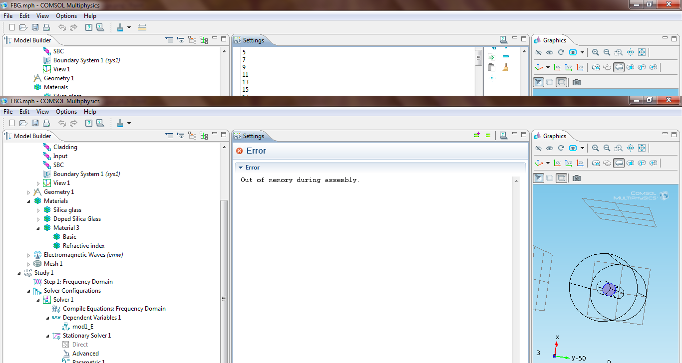

I've tried like the pics. But it says out of memory. Im really in a great trouble.
what should I do with it now?
Thanks in advance.
I've tried like the pics. But it says out of memory. Im really in a great trouble. what should I do with it now? Thanks in advance.

well first I do not see why you define NZ, you can use directly "z" no ?
then if it is for a periodic index variation, probably you should check your offsets and the formula should read something like ...sin(2*pi*(z-Z0)/0.5[um])) with a Z0 defined per domain, as I see that this material property is applied to many elements.
Finally in wave and optics you need a very fine mesh, which means that you need a lot of RAM (mesh density < 1/5 of the wavelength IN THE MATERIAL (do not forget "n" the index effect!)
One way is if your model is symmetric, you might be aple to use a 2D-axi, but sometimes with some types of polarized light the axisymmetry is not respected
Have you tried to see how the index varies, if it is correctly entered ? The easiest is to select the "dependent variables" sub node in the solver sub-tree and do a right click "compute to current/here" This will load in all initial conditions, you can then use the Results section to visualise the initial values, such as index variations, initial fields etc
Hi well first I do not see why you define NZ, you can use directly "z" no ? then if it is for a periodic index variation, probably you should check your offsets and the formula should read something like ...sin(2*pi*(z-Z0)/0.5[um])) with a Z0 defined per domain, as I see that this material property is applied to many elements. Finally in wave and optics you need a very fine mesh, which means that you need a lot of RAM (mesh density < 1/5 of the wavelength IN THE MATERIAL (do not forget "n" the index effect!) One way is if your model is symmetric, you might be aple to use a 2D-axi, but sometimes with some types of polarized light the axisymmetry is not respected Have you tried to see how the index varies, if it is correctly entered ? The easiest is to select the "dependent variables" sub node in the solver sub-tree and do a right click "compute to current/here" This will load in all initial conditions, you can then use the Results section to visualise the initial values, such as index variations, initial fields etc -- Good luck Ivar
