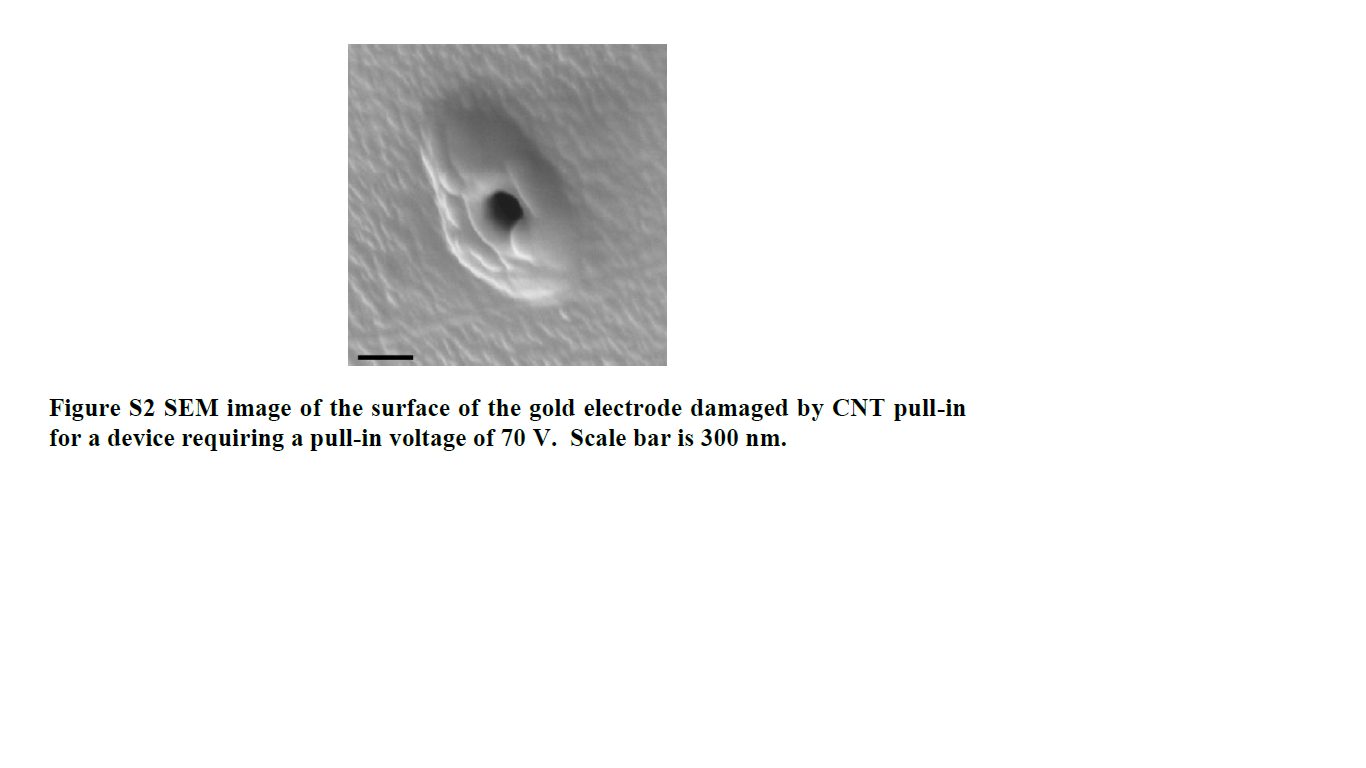

I spoke with a friend of mine who knows a lot of nanochemistry and he told me that indeed things can get very hot at nanoscales. However, he compared data with some plasmon papers he's read and temperature never got that hot. So he suggested that as temperatures are so high, maybe I shouldn't understimate the heat transfered to ambient by radiation. So I put some radiation boundary conditions, but the model didn't converge, that's logical, because radiation is of the order of T^4, so if T was already high, the radiation is simply ridiculous.
I've been through all the Joule heating and MEMS examples, but they conveniently use very low voltages as inputs. For example in the MEMS Joule heating example, they do a parametric sweep between 3 mV and 10mV. Reaching a maximum of 792K. However if I change the voltage to 200mV, the temperatures rise up to 1.2*10^5 K. I did some hand calculations and maybe the temperature isn't that bad. However, all the papers I've checked while doing this project have used voltages as high as 48V and It seems ther isn't any supernova reported in any of them. I know there should be really high temperatures when you reach voltages as high as 70V and there must be superheating effects like the one in the photo attached, but It seems that they can live with voltages of 5-20 V.
