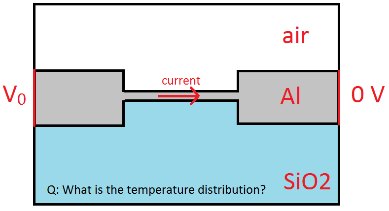

I am trying to do the simple task of drawing a 2D metal rectangle embedded in some dielectric, pass a current through, and plot the temperature distribution due to heating (which will be hottest where the bar is narrowest).
I have attached a file with a 2D metal bar between. I am getting the error "Singular matrix. There are 1806 void equations (empty rows in matrix) for the variable mod1.V...."\

I thought it might be helpful to attach an image of what I'm trying to simulate. It is really a simple structure, just trying to find What is the temperature distribution in a thin Al sheet sandwiched between SiO2 and air, in a 2D (cross-sectional) format.
