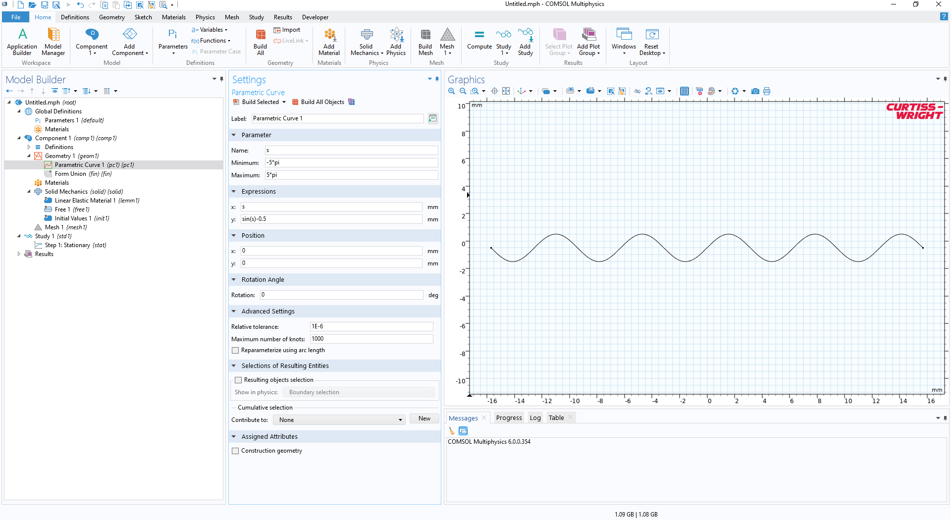

Use the parametric curve, found under "more primitives" when right clicking the Geometry node.
You can scale it accordingly...
Use the parametric curve, found under "more primitives" when right clicking the Geometry node. You can scale it accordingly...
