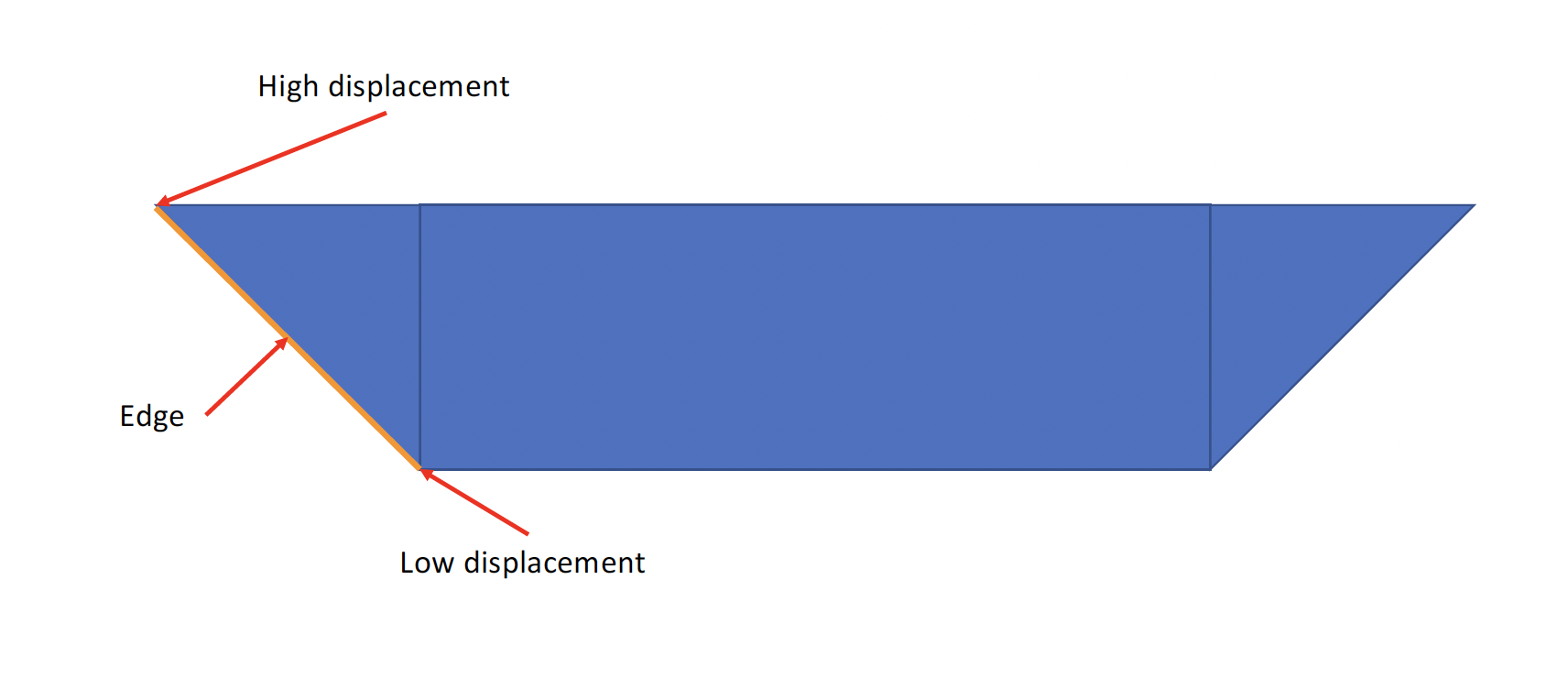

I used the Prescribed Displacement condition to control the displacement that I needed, but the issue is the displacement is applied to the whole ( Edges or Facets).
I want a different value of displacement that I need to apply to the condition. For example, the displacement at the top of the edges should be high, while the displacement at the bottom of the edges should be lower (close to zero) at the bottom of the edges.
I attached a 2D image of one facet to show my point.

The COMSOL GUI is interpreted, so you can type as the displacement imposed on an edge an expression that depends on coordinates. There's also a parametrization of each edge and face you could use for that purpose though I wouldn't necessarily recommend it (See Reference Manual, version 6.0, page 322 for all the details). Best,
