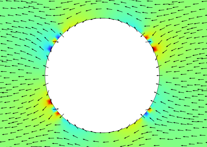

I am trying to solve Laplace's equation subject to a non-linear boundary condition. T corresponding solution in the bulk of the domain is what I would expect. However on the boundary I have these strange points of discontituity that I cannot seem to get rid of. Advice on how to remove these would be ideal.

I use the standard equation solver and when I compute the solution I get these strange points of discontinuity along the boundary (see the attached picture). I am unsure how to get rid of them. I tried to use the inbuilt mesh adjustment, yet that simply did not converge.

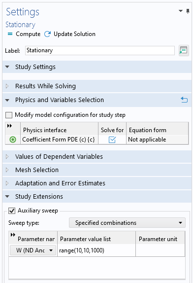

Since the strength of the nonlinearity in your problem is directly proportional to the parameter W, I think it makes sense to solve for a lower value of W and see if the solution converges. If that is the case, you can use such a solution as initial value for a new solution with higher value of W etc.
This procedure can be automatized by using an auxiliary sweep, see the attached screenshot.

That seems to have worked really well, thank you.
