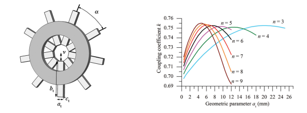

I am willing to simulate a 3D ferrite bar transmitter where coupling coefficient k and Bt magnetic flux density on the each side uses the finite element method for solving partial differential equations.
The Magnetic Fields module has equation (jωσ − ω2ε0εr)A + ∇ × H = Je,
which enables calculation of magnetic field distribution B = ∇ × A, where ω is the angular frequency, σ is the electrical conductivity, ε0 is the permittivity of vacuum, εr is the relative permittivity, A is the magnetic vector potential, H is the magnetic field intensity, B is the magnetic flux density, and Je is the external current density.
