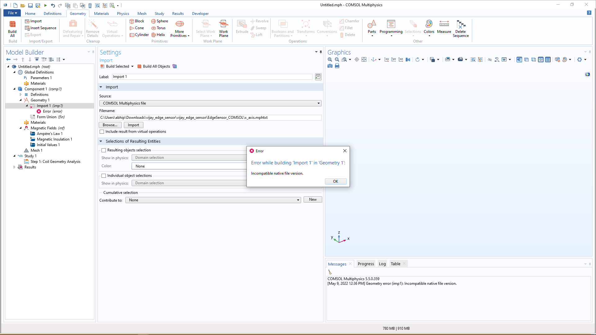

Hi, I have generated x and y coordinates in MATLAB for a square spiral coil, which is saved as a .txt file. I am having trouble importing the coordinates to COMSOL. 1) What type of file does COMSOL accept? 2) In which format should the coordinates be saved to be imported successfully?
Thanks in advance! Divya
