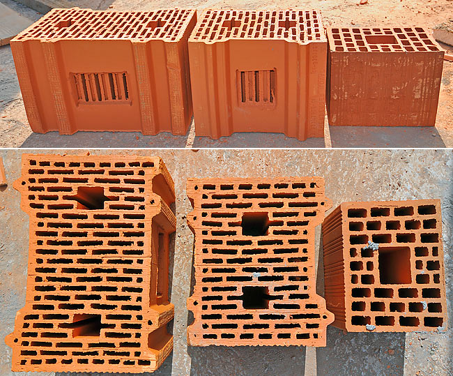

I modelled the heat transfer within a block with some air gaps. In the model, heat is transferred by conduction in the solid domain, and in these air voids, convection and radiation are also involved. I have attached a picture of the block.
That problem is that the computational process is extremely slow. With very coarse mesh, it takes nearly 2 hours to get the simulation result.
