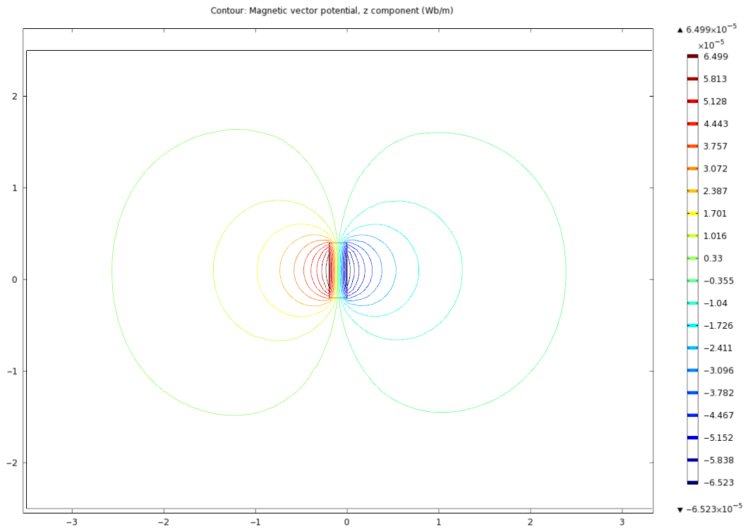

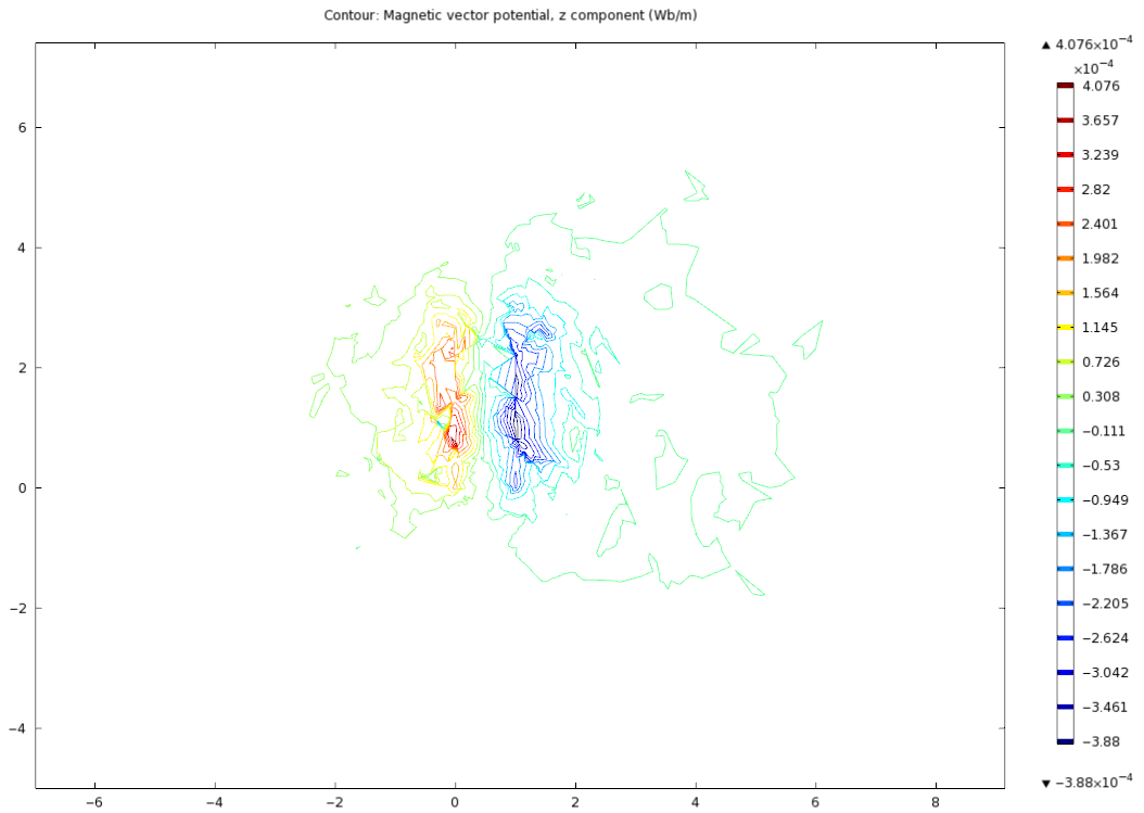

At the moment I'm just trying to model basic permanent magnets then get contour (or streamline) plots of the magnetic field going from one pole to the other. While I can happily do this in 2D and get a good looking plot using the magnetic vector potential normal to the plane I'm viewing (attached image "2D plot"). The problem I get is when I build effectively the same configuration in 3D (a cuboid magnet), then take a 2D slice through the centre of the magnet and plot the same magnetic vector potential (attached image "3D plot").
I'm assuming my problem is that the mesh density on that plane taken from the 3D model is much less than it is for the 2D plot. Therefore, I was wondering if anyone could tell me how I would go about re-solving just on this plane at a higher mesh density. Alternatively, please tell me if there's a different issue that's causing this.
