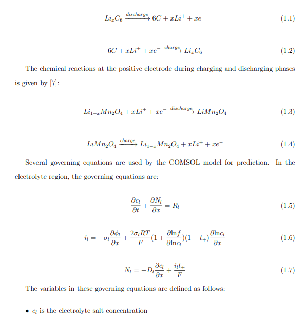

Hi, I want to create a simple 1D electrochemistry battery model, where I want the resulting charge and discharge behaviour in a battery vs time and 1C or 2C rate also.
I think already model available for Lithium-Ion batteries (liion), but I do not have a licence for this. I think it is possible to get the result by using PDE and Transport of Diluted Species.
I have attached a screenshot to understand it better.
I will be thankful to you if you kindly assist me.
