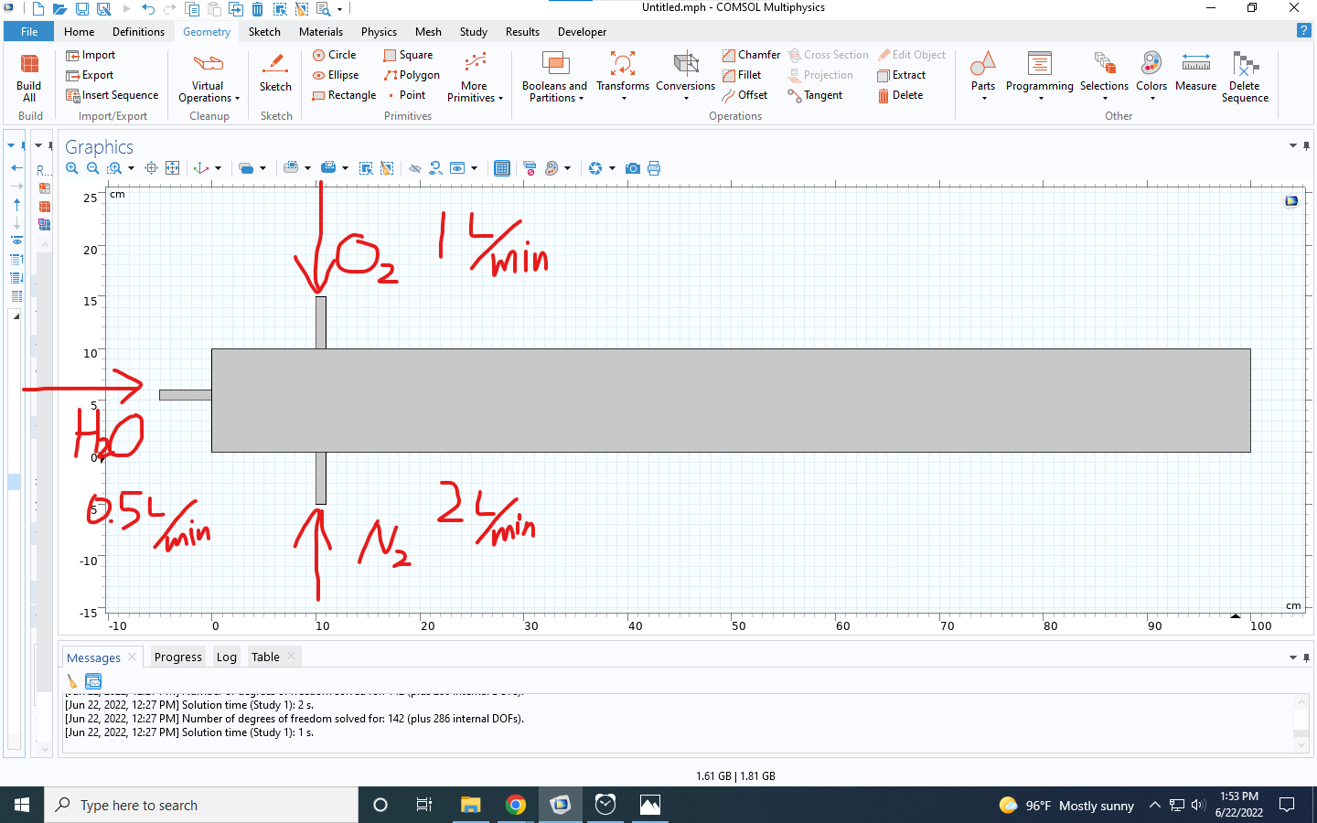

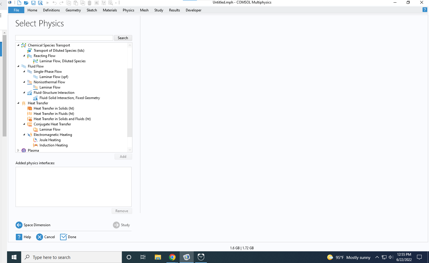

Hello! I am new to Comsol and currently trying to simulate CFD with Comsol 6.0. More precisely, I need to set up the main tube which has 2 side tubes (one carries oxygen and another does nitrogen) and find a distribution for each substance. To clarify what I'm talking about, I've attached the image of the simualtion that I need to set. Although, I do not have CFD module since my university wants me to try to simulate without buying any module if possible. Therefore, I wanted to know if I can possibly to simulate only with what I have or have to purchase other modules such as CFD or Porous Media Flow module. Also, if I can simulate with what I have now, I'd like to know how. I have also attached the Physics that I have now to show which option I can use. Thank you!

This may not be the only factor to consider, but do you expect the flow to be turbulent? It seems plausible from your sketch. If so, you will need either the CFD Module or the Heat Transfer Module. Turbulence is not something you can realistically hope to implement on your own. The CFD Module includes more turbulence models than the Heat Transfer Module, and of course they also each have their own unique features, see the Specification Chart for a list of capabilities in each of those modules and read this blog post for a discussion of when each turbulence model applies.

Thank you for your replying. I expect the flow to be laminar since velocity would be very small. Even in that case, my guess is that I have to purchase Porous Media Module to simulate multiple chemical substances and find each concentration. Do you think there is any way that I can do those procedures without buying new modules?
