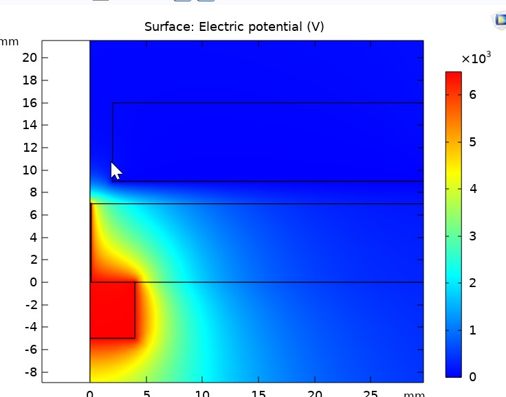

Hello, I am trying to find electric field generated by an emitter plates for elctrospray process. I have made a 2D diagram with a hole size of 0.2 mm in PTFE Material. I have modelled two electrodes seprated by a distance of 2mm. I have applied about 6500V to the electrolyte which is modelled to be inside the hole.

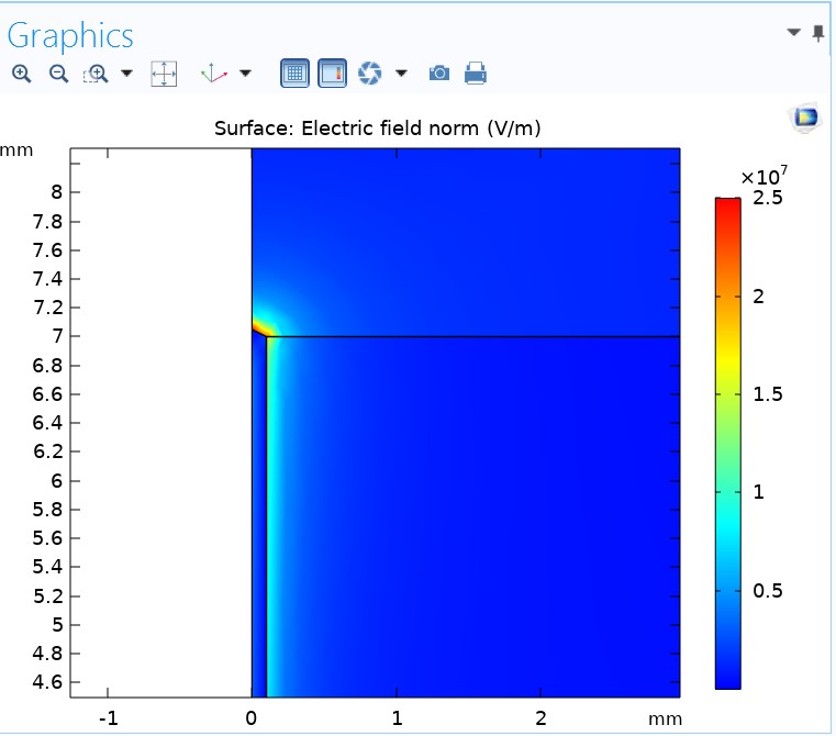

My question is that i am getting same value of electric field even after changing the material properties although the potential difference distribution looks right. Can you please tell me the reason for this?
I am getting same value of electric eventhough the material electric conductivity is very apart.
I have attached the pictures for your reference
