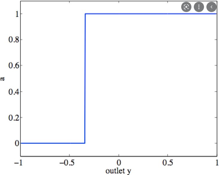

I'm trying to make 1D-purely advective chemical flow, whose breakthrough curve should be look like the captured figure I uploaded.

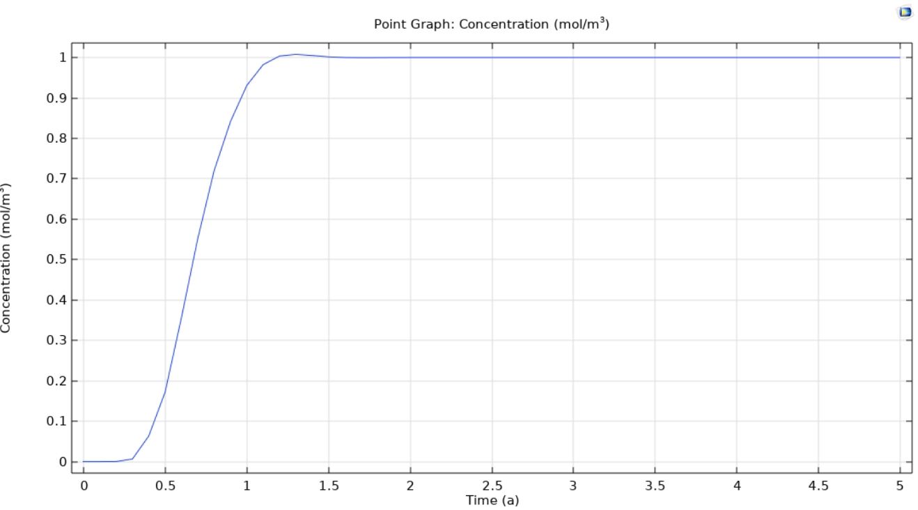

Since there is no diffusion, dispersion, reaction, source, and adsorption term, I think the system should be purely advective, but the result was not the same as what I expected.
I uploaded the breakthrough curve I got from the COMSOL. What should be additionally done to make the system purely advective?
