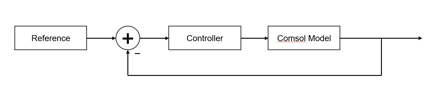

Hi, I want to use a Comsol model in Matlab where I want to update a parameter after each iteration. Is there any way to use a study that calculates only a single time element and then updates the parameter in Matlab and then calculates the next single time element.

is there any way to calculate the solution in Matlab using state space extraction, as I am currently designing a controller for the model and my company has only given the "LiveLink for Simulink" license to the license bool for the coming quarter, so this will not be available until November.

The problem with this controller lib is that I am not using a PID controller. In my case I would use a state space controller and so I want to extract the states or use this single shot. As I said, the license is requested but not solved yet. Maybe you have an idea how to extract the SS model, because when I extract that the first time it works, but on the second run the Matlab console gives the following error message and I don't always want to remove that manually.
Error using mphstate
Solution already contains an active StateSpace node.
Error in State_Space_MJ1 (line 25)
M = mphstate(model2,'sol1','out', {'MA' 'MB' 'Mc' 'C' 'D' 'x0', 'Null', 'ud'},...`
Thank you for your expertise The problem with this controller lib is that I am not using a PID controller. In my case I would use a state space controller and so I want to extract the states or use this single shot. As I said, the license is requested but not solved yet. Maybe you have an idea how to extract the SS model, because when I extract that the first time it works, but on the second run the Matlab console gives the following error message and I don't always want to remove that manually. Error using mphstate Solution already contains an active StateSpace node. Error in State_Space_MJ1 (line 25) M = mphstate(model2,'sol1','out', {'MA' 'MB' 'Mc' 'C' 'D' 'x0', 'Null', 'ud'},...`
