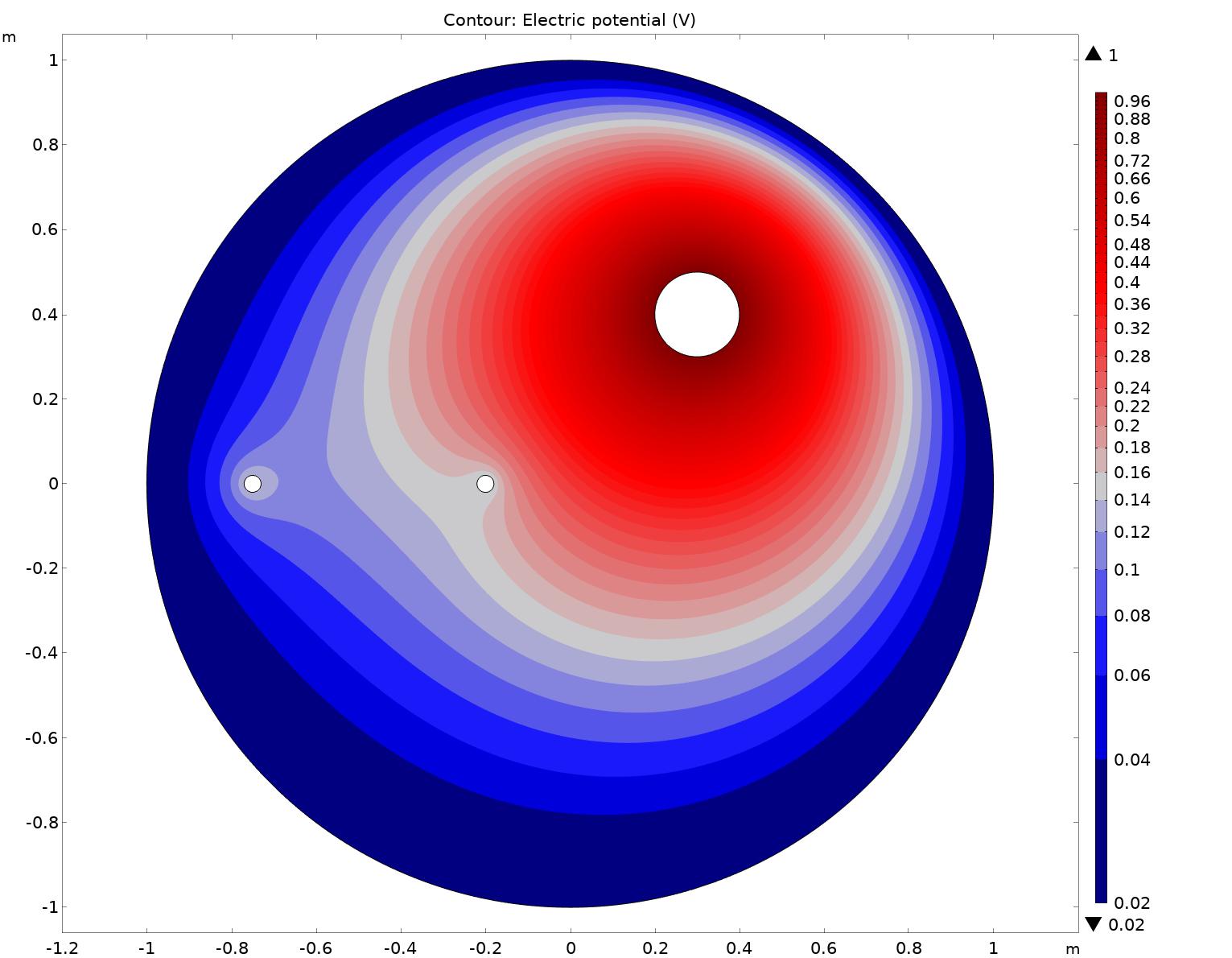

If you are doing electrostatics, you can force floating potentials on different surfaces to match each other fairly easily. See the attached example and a picture of the potentials in the solution. The two smallest circles are set at floating potentials that are constrained to be equal.
