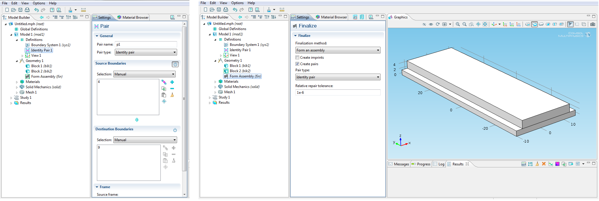

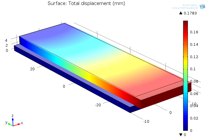

I am not still able to work my model out, using the Assembly mode.
Considering a simple model, that is two beam connected (such as a multilayer). The extremities of these beams are fixed, and the opposite extremities are free.
Only the upper beam is at high temperature.
In fig.1 as attached you can see how I set the assembly mode and the Identity Pair (4 and 9 are the two faces in contact) and in fig.Displ you can see my result: It is obvious that is wrong, only the upper beam deformed.
Notes that:
In this case I could have used only mapped meshes, but we can assume we want a tetrahedral mesh on the upper beam.
I am not using "Imprints" in the Finalize node otherwise I saw it is not possible to use the mapped mesh (I will have 3 faces of destination, not 1 face). Practically, the same problem using Union mode.
Where am I doing wrong with Assembly?

Posted: 1 decade ago 2012/09/10 4:31 JST
did you add a node : Solid - Boundary - Pair - continuity and selected the identity pair ? I bet not ... hence no continuity ...
Hi did you add a node : Solid - Boundary - Pair - continuity and selected the identity pair ? I bet not ... hence no continuity ... -- Good luck Ivar
Posted: 1 decade ago 2012/09/10 6:46 JST
Hi Ivar,
You're right! I didn't know the setting of this node. Now everything works correctly
