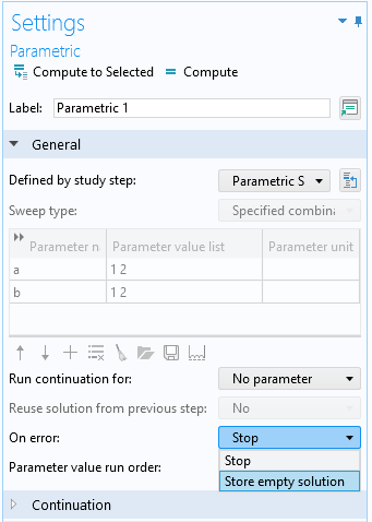

You can control that behavior using the On error control in the Parametric node, see the attached screenshot.
Henrik Sönnerlind
COMSOL
You can control that behavior using the *On error* control in the *Parametric* node, see the attached screenshot.
