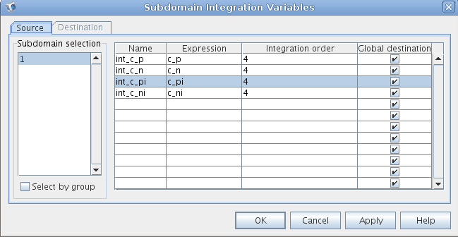

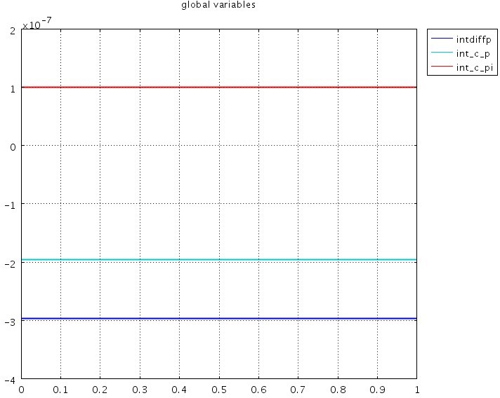

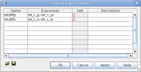

Dear Ivar,
thanks a lot for the answer! I am indeed working with Version 3.5a.
Int_A0 is the integral of the initial value of A over my subdomain (and A_0 the same everywhere, thus int_A0=A0*area). My area so far is not changing, so this is constant, so I could indeed give int_A0 as a true constant. But then, eventually, I do want to investigate the influence of a changing area, and then I could not change the area solely, but then would have to calculate int_A0 again and type it in as well, which I would like to avoid. (Or is there a predefined variable for the area/volume of a subdomain that I could use for the definition of a constant?)
I tried as you said, but to me it seems as if the condition int_A-int_A0=0 is not yet implemented. I attached three images - my inputs for the integration coupling variable, the global variable and the result I get (in my model, A=c_p and A0=c_pi (analogue for c_n)). What is missing?
All best,
Sabine
