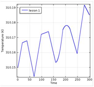

I have another query. Regarding the temperature profile? Since I am irradiating the boundary using a sin wave. So, I am assuming that the temperature profile at the irradiated boundary should behave a similar nature like a wave. But I am getting temperature curve at a point on the boundary straight lines. It is not following a sin nature. I am using time step of 0.1 for time marching procedure. But I think the temperature profile is not taking all the time steps it is skipping certain points. It is showing irregular straight lines like it has skipped few points. I am not sure what is the problem.

indeed it looks like the time stepping is being too coarse, the thing is that by default COMSOL assumes a diffusion type model decay, so when you have a periodic BC you must tweak a little the time stepping settings.
Use rather an intermediate or a strict time stepping (and not the default automatic for periodic BC conditions) then be sure you define enough time steps per periode, 5 as absolute mnimum 10 or more is better (it all depends on the time you ant to wait for the solution ...
Thne you can also consider a gen-alpha, in case of converging issues

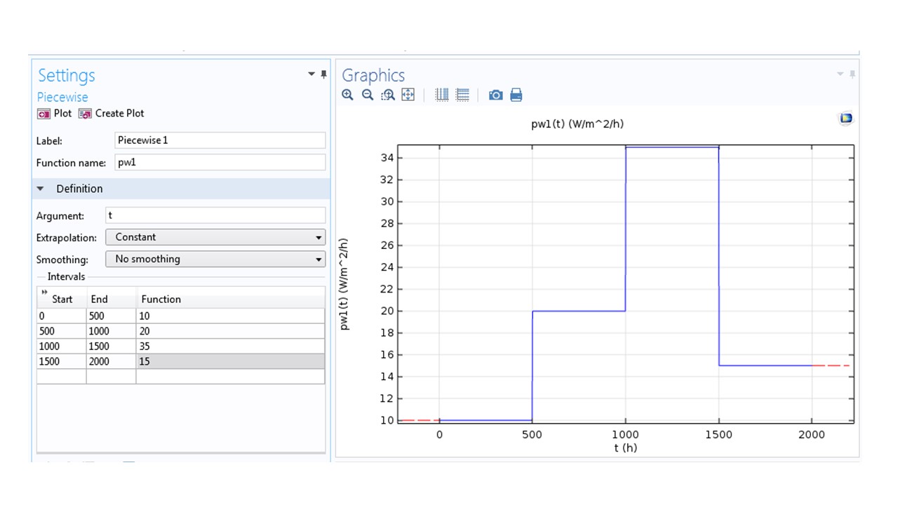

I have a similar problem. I have to set my convective heat flux depending how much time as passed.
For example;
Time (s) 0-500 set h=10
Time 501-1000 set h=20
Time 1001-1500 set h=35
Time 1501-2000 set h=15
How do I covert this into a IF statement to insert into the "Convective heat flux" field ?

Make a piecewise function, say pw1, and call it then pw1(t). See attachment.

I have done the piecewise function, but how are you plotting that graph with h as a function of t?
When I plot the graph I don't get any labels at all.

The function set-up window (my attachment) asks for the units of the argument and the function. You must fill in them properly.
