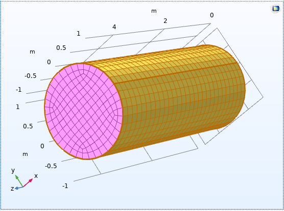

For a cylinder, choose one of the end faces as the source face, and then choose Quadrilateral (generate hexahedra) as the face meshing method. See the attached screenshot.
And yes, you can import meshes from NASTRAN, STL, VRML, sectionwise, PLY, and 3MF files.
Magnus
