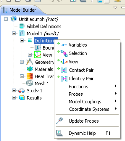

I cannot find the Infinite element domain node, which I thought was under Definitions. I'm using the Heat Transfer in Solids in the base package. If it is not available there, where could I find it?

there has been some changes in 4.3, to make all physics similar, I eelieve its under Global Definition ? I would have to check the doc too, anyhow, its worth to reread the doc regularly, specially when they change such issues, as the hypotheis might change too
Hi there has been some changes in 4.3, to make all physics similar, I eelieve its under Global Definition ? I would have to check the doc too, anyhow, its worth to reread the doc regularly, specially when they change such issues, as the hypotheis might change too -- Good luck Ivar

Dear Mr Peterson,
I had the same problem: For using the infinite element domain
you need the corresponding Comsol module for _each_ used
physics interface (AC/DC for es, Microfluidics for chds...).
The base package has no infinite elements, though it is documented in there.
Dear Mr Peterson, I had the same problem: For using the infinite element domain you need the corresponding Comsol module for _each_ used physics interface (AC/DC for es, Microfluidics for chds...). The base package has no infinite elements, though it is documented in there.
