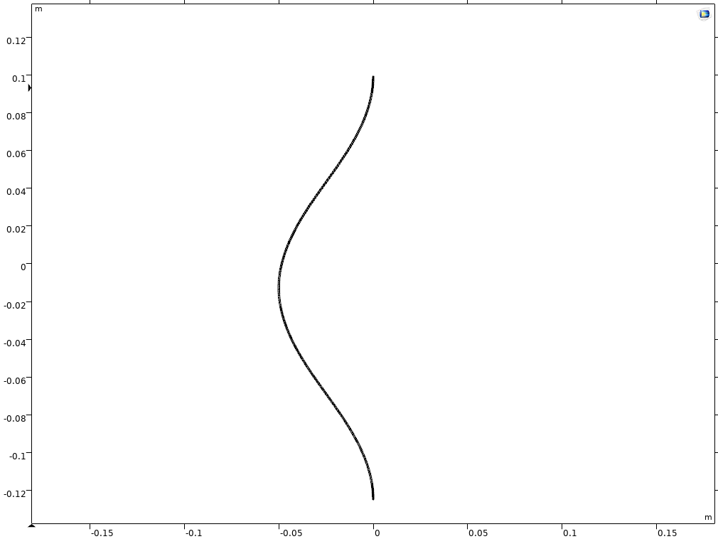

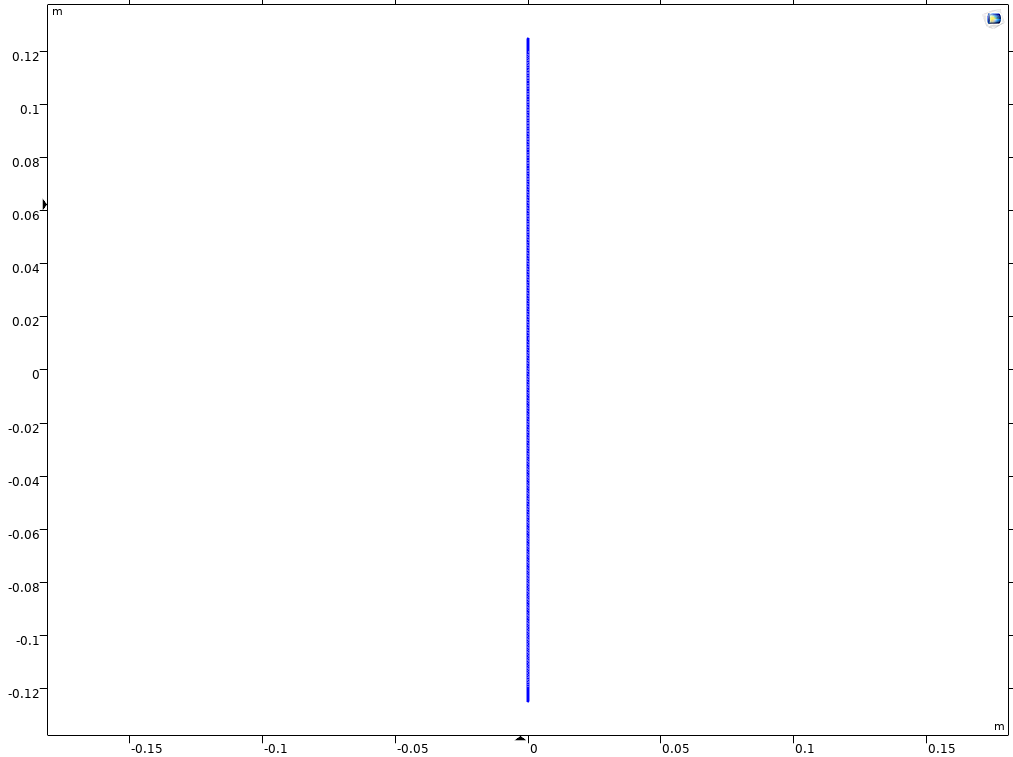

I have a linear elastic thin beam (2D), which I am buckling (first mode) to a desired clamp-to-clamp distance in a stationary study. I now want to take this buckled beam into a fluid filled tank (also 2D) and perform further structural analysis in the fluid medium (FSI). (The situation is like, I am buckling a beam in air, then taking it underwater for further analysis.)

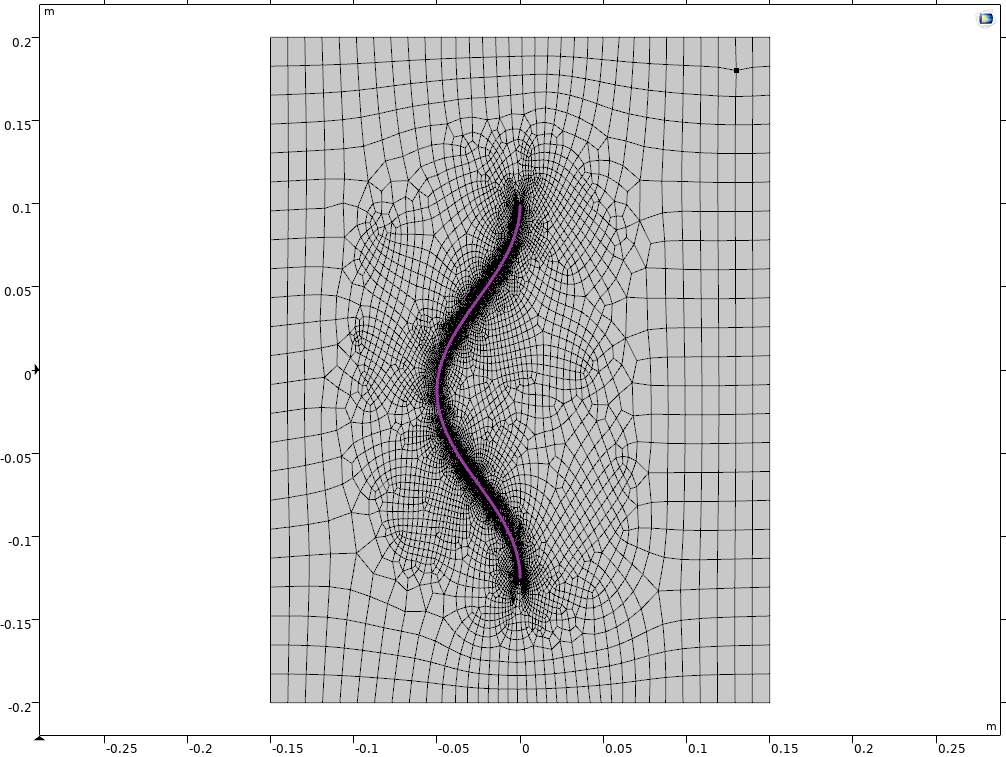

I have remeshed the deformed shape of the beam and used it as geometry input for the solid part of the FSI (as explained here: https://www.comsol.com/blogs/how-to-reuse-a-deformed-shape-as-a-geometry-input/ ... (1)), and I have a rectangular fluid tank around this geometry.
