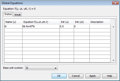

Posted: 1 decade ago 2012/11/17 3:15 JST
In step 4, correct your equation: it should be
Nt-N+N*N
, as Nt means derivative w.r.t. time and you have to enter the expression which is null-valued.
In step 5: after selecting only ODE, press OK.
In step 6: select your times and press OK.
Step 7. Press the SOLVE button (symbol "="), or in Menu > Solve > Solve Problem.
Try these steps, please.
Jesus.
Hi, In step 4, correct your equation: it should be Nt-N+N*N , as Nt means derivative w.r.t. time and you have to enter the expression which is null-valued. In step 5: after selecting only ODE, press OK. In step 6: select your times and press OK. Step 7. Press the SOLVE button (symbol "="), or in Menu > Solve > Solve Problem. Try these steps, please. Jesus.
Posted: 1 decade ago 2012/11/17 3:34 JST
hi
Nt-N+N*N
it gives error
duplicate variable
N
Nt
Ntt
n
Nt
Ntt
variables are repeated?
for step 4
Name (u) equation f(u,ut,utt,, t) init (u) init (ut)
N Nt - N + N*N 0.5 ?
please correct if wrong.
regards
hi In step 4, correct your equation: it should be Nt-N+N*N , as Nt means derivative w.r.t. time and you have to enter the expression which is null-valued. In step 5: after selecting only ODE, press OK. In step 6: select your times and press OK. Step 7. Press the SOLVE button (symbol "="), or in Menu > Solve > Solve Problem. it gives error duplicate variable N Nt Ntt n Nt Ntt variables are repeated? for step 4 ---------------------------------------------------------------------------------------------------------------------------------------------------------- Name (u) equation f(u,ut,utt,, t) init (u) init (ut) ---------------------------------------------------------------------------------------------------------------------------------------------------------- N Nt - N + N*N 0.5 ? ----------------------------------------------------------------------------------------------------------------------------------------------------------- please correct if wrong. regards
Posted: 1 decade ago 2012/11/17 3:40 JST
See the image attached.
Good weekend.
Jesus
See the image attached. Good weekend. Jesus
Posted: 1 decade ago 2012/11/17 15:37 JST
hi
the similar i did. but error duplicate variables. how to handle it?
tc
hi the similar i did. but error duplicate variables. how to handle it? tc
