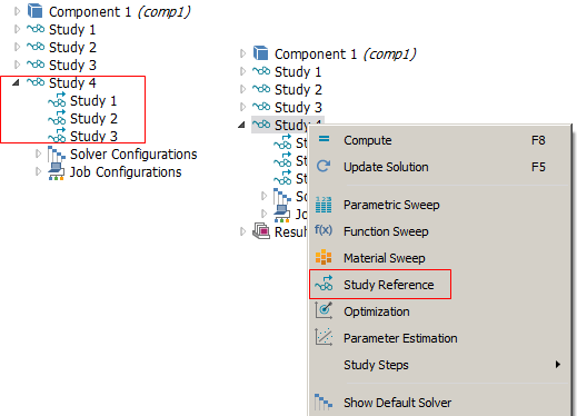

Posted: 9 years ago 2016/08/09 20:30 JST
Yelena,
Yes, you can select several studies into a single separate study using "Study Reference" options, as shown in the attached image.
Sergei
Yelena, Yes, you can select several studies into a single separate study using "Study Reference" options, as shown in the attached image. Regards, Sergei
