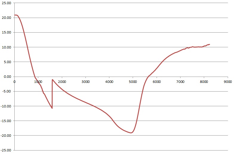

Hello everyone, relatively new to COMSOL here, I am trying to create a model
describing a simulation that took place in a climate chamber. I have attached a
graph describing the temperature on the water container surface. I want help modeling
that step-up near the 1600s mark, how should I "make the water warmer" before it starts
cooling again? I have looked into the continuous casting model for guidance and I have
used some methods described in it but I am stuck...
The physics I use is heat transfer in solids and the custom water I have
has a Cp = 4200 - (2120*(T<T_freeze)) +exp(-(T-T_freeze)^2/((dT)^2))/sqrt(pi*(dT)^2)*333000
where dT=1[K] and T_freeze = 0[degC]
Any help would be welcome!
Thank you!

Thank you for your reply, I have used flc2sh to produce a smooth "step" but it
gets smoothed or averaged over instead of having that relatively steep step.
I don't mind so much at the moment because the final result is "close enough"
but, you know how it is, wanting to get it precisely right ;)I tweaked the solver to
take 0.5 sec steps around the step area but it did not do any difference.
I am starting to believe that if the water is treated as a solid, the moment of
crystallization isn't simulated correctly.
Again, thank you for your time Mr. Kjelberg

Hello Jesus and thank you for your reply. The water in this simulation acts only as a heat storage medium.
The "problem" is that in during the climate chamber simulations the water is standing still and thus allowed
to be supercooled before turning into ice. I might have to repeat the simulations trying to force the phase transition
(by jiggling the container maybe?) around the 0°C point in order to get a smoother behavior.
The water is cooled and warmed by a "Temperature" boundary condition applied on a plate
underneath the container.
By phase coexistence do you mean a "mushy" state? I don't think that is necessary at the moment.
I have considered making the model a bit more complex to account for movement in the liquid but again
I think that is too complex for what I am trying to simulate.
Thank you for your time and advice!!
