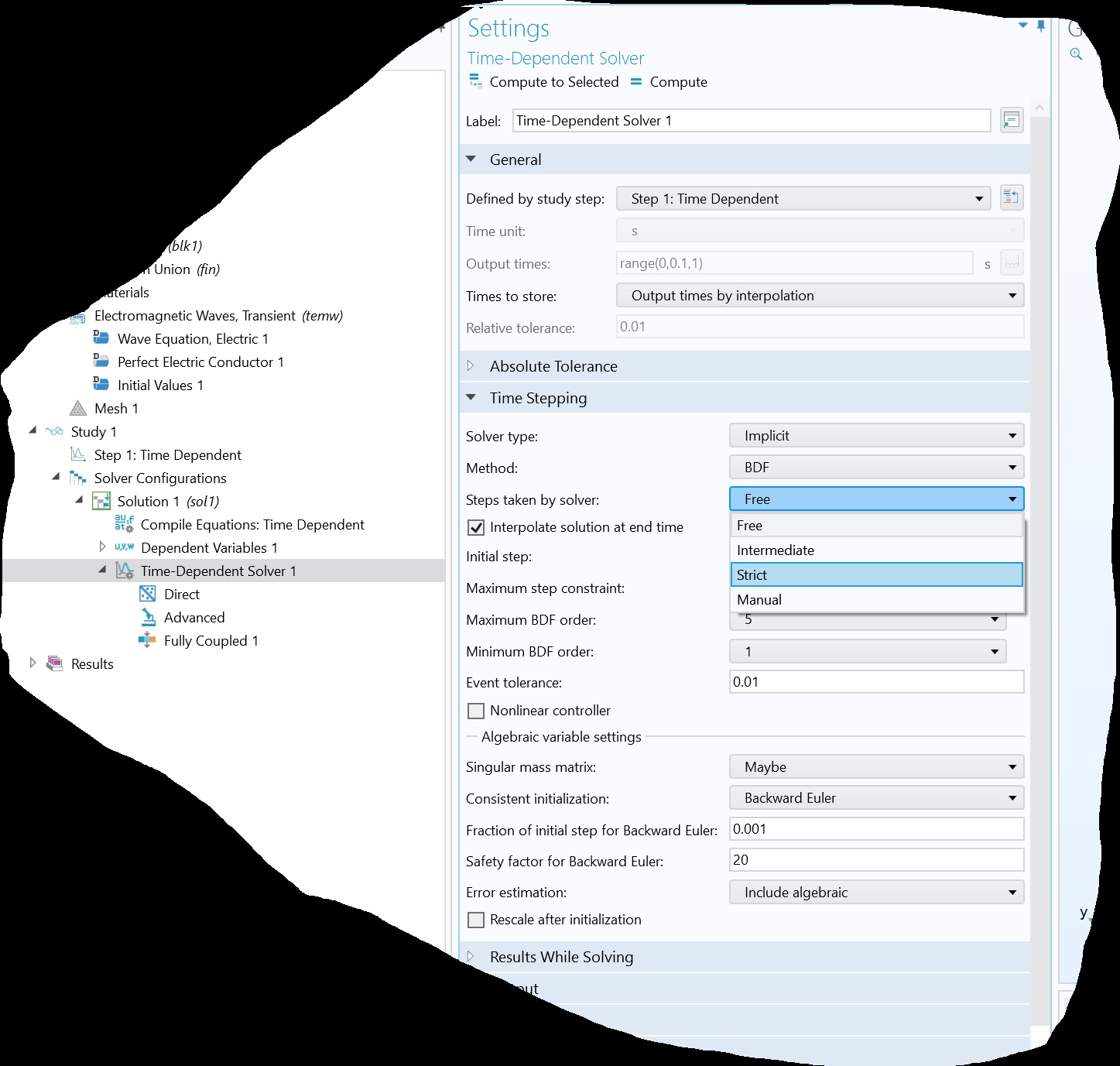

Thank you.But I do not konw how to choose the "manual" option for my time stepping, and Where to choose strict?

Thank you. My voltage is the AC signal, the sin function,V=50sin(2pi200t), and the viscosity of the fluid is the e index,0.05823+(1.27386-0.05823)*exp(-t[1/s]/23.022). Both functions contain time. The specific details of the time step are not very clear.

Posted: 3 years ago 2023/03/04 11:18 GMT-5
I've attached a picture. This example is unrelated to fluid dynamics, so do not assume any other settings shown apply in your case. Anyway, I encourage you to study Comsol's provided application examples and familiarize yourself with the best settings for various time-domain problems of relevance to you.

Thank you very much. Do you need to divide the research into two steps, the first steady state and the second transient state? My research questions: the first part is the transient change of the double electric layer, the second part is the velocity change of the fluid, both of which are related to time.
