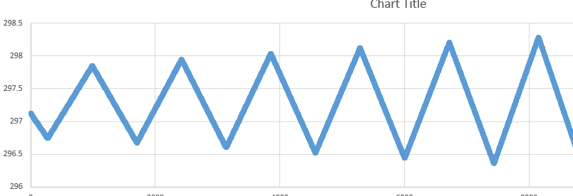

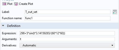

Hi, I'm trying to specify a time dependent sinusoidal temperature boundary condition. I've defined a function in the screenshot attached. However, when I run a time dependent solver, the temperature of the boundary I've defined comes out looking jagged and not steady as seen in the second screenshot. How do I fix this issue?

Sarah,
you probably need to adjust the time stepping. For periodic signals you should set manual time steps that resolve the waveform. The automatic time stepping ignores the periodicity of the waveform. This is about the time steps in the solver, not the time steps you set in the study step.
Cheers Edgar

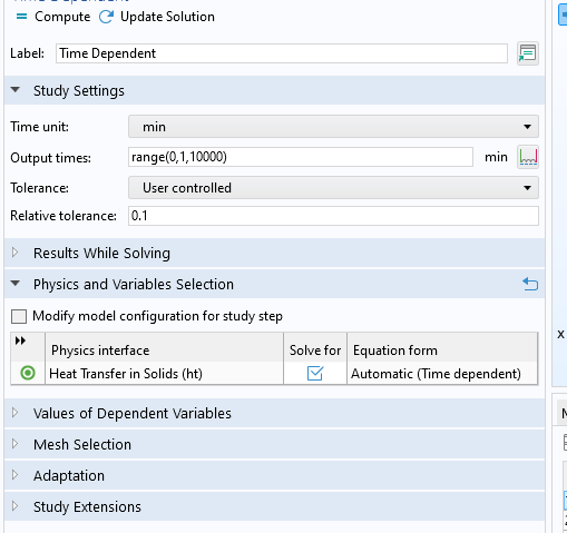

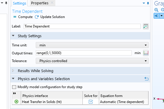

Hi Edgar, How do you set manual time steps? I've tried both of these (attached) in the time solver. Thanks, Sarah
Posted: 3 years ago 2023/03/13 18:22 GMT-4
Those are the settings in the study step.
You need to change the time stepping in the solver. That is in Solver Configurations -> Time Dependent Solver -> Time Stepping
Edgar J. Kaiser
emPhys Physical Technology
www.emphys.com
Those are the settings in the study step. You need to change the time stepping in the solver. That is in Solver Configurations -> Time Dependent Solver -> Time Stepping
