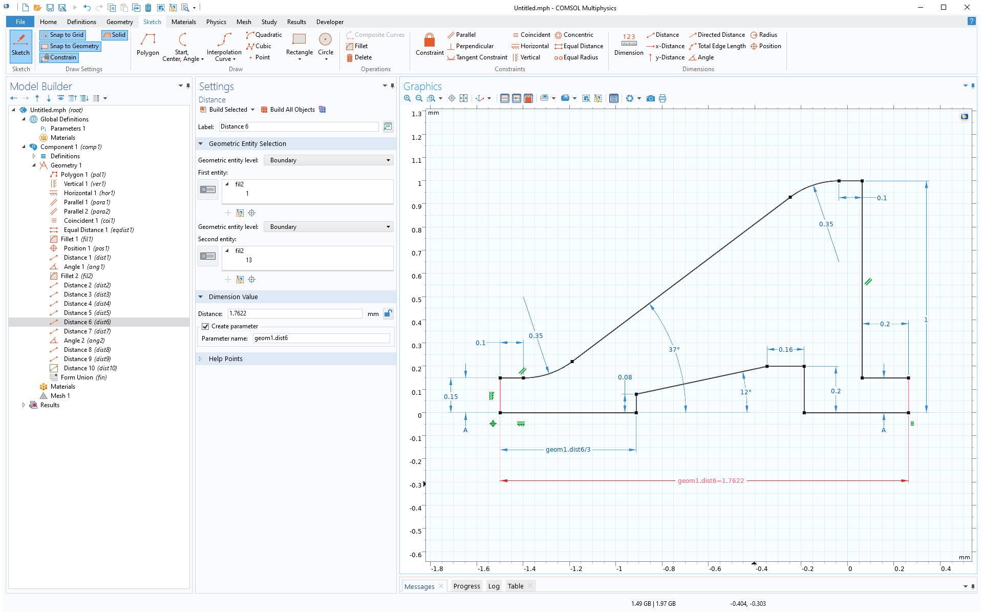

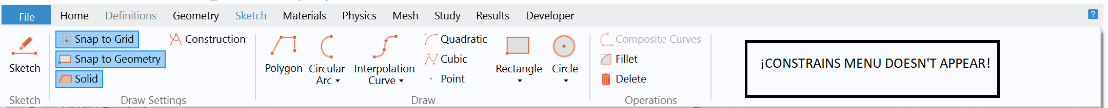

I have version 6.1 ClassKit Edition. I would like to use the "constrains" option, found in the "sketch" tab, to be able to limit the different distances that appear in my geometry, but I can't find it (As seen in the attached image).
I would really appreciate it if someone could tell me how to activate this option

This is a functionality included in the optional Design Module. Could it be that your license does not include that product? You can check on that by going to File > Used and Licensed Products.

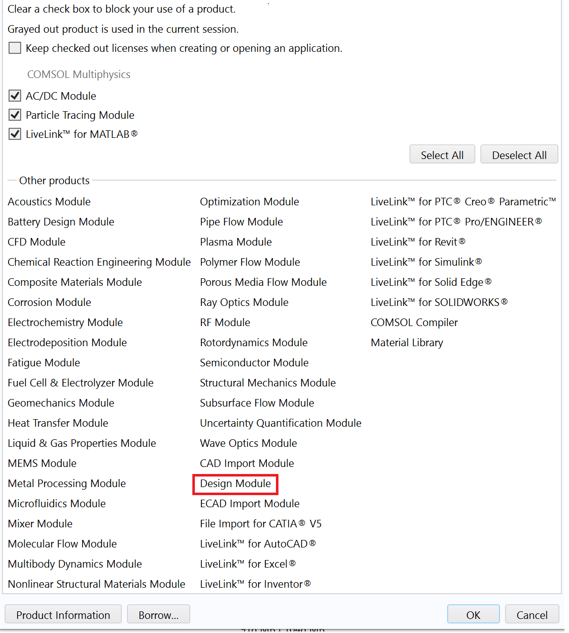

Thank you very much for your answer. I have reviewed it, and as you will see in the attached screenshot, it is included in my license. So it seems that the problem comes down to "make visible" the particular constrains option, which I just don't quite see how to do.

Okey, I think you were right, it's in the "other products" section, so I don't think it's in the license I have.

No, you really need the Design Module to do that in COMSOL.
Could you draw the geometry outside of COMSOL? Well, from the screenshot you posted earlier, you can tell that your license does not include any of the optional add-ons that increase what CAD formats you can import into COMSOL; this greatly decreases your options. With that said, there are some basic formats that can be imported with just the core COMSOL Multiphysics package, see the CAD specification chart, so if you have access to a third-party program that can generate dimensioned drawings and can export in one of those formats, that would be a way to go (With the caveat that you will not see or be able to edit the dimensions in the COMSOL GUI after import).
