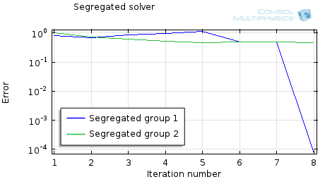

I'm currently trying to simulate a flow of hydraulic oil through a valve however, I keep getting the following error:
Failed to find a solution.
In segregated group 1:
Divergence of the linear iterations.
Returned solution is not converged.
I'm relatively new at using Comsol but this forum has giving me a lot of information and I've solved many of my previous poblems using your answers although I couldn really find anything about my current problem. I've tried to fix the stated problem by increasing the Factor of error estimate which did'n do anything.
It's a rather simple geometry at 220x160x140 [mm] and Im having enough elements for the boundary layer mesh to be without errors or problems which leaves me at 271206 degrees of freedom.
I've included the convergence plot.

CFD is tricky indeed, often the initial conditions are too far off, then try to refine them or make a first steady state at lower flow, then ramp up from there, or you need to increase drastically the number of max iteration (default 25) or sometimes, you are missing a complete BC such as a gauge pression settings.
Also if you have enough RAM you could try to run a direct solver, sometimes they work better, depends on the model there is no single answer.
CErtainly plotting velocity and pressure helps often to see what is happening. Not to say in case of turbulent flow its trickier ^n ;)

First of all in your graph Segregated group 1 does converge, it is Segregated group 2 not to converge in time. However, if you need help you need to upload yoru model, this piece of information is not enough.

The solution to my problem was actually very simple = direct solver.

PS. Amir, I found that odd as well. Segregated group 1 seemed to converge however, I got the error stated above. No explanation that one though:-/
