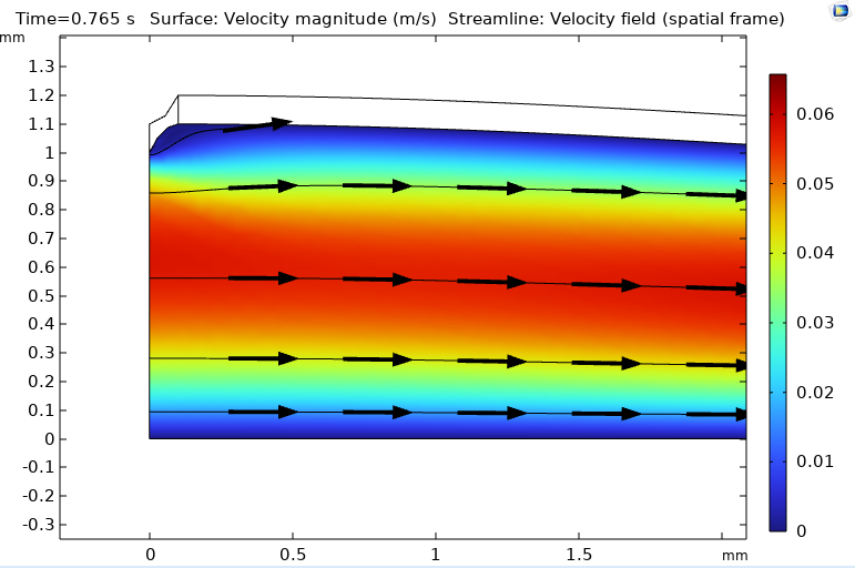

I am currently working on a fluid flow in a tube whose walls are moving with the form of a propagating wave using the solid Mechanics module with the prescribed displacement option.
I deployed a pressure boundary condition on the inlet and the outlet (5Pa and 0Pa). The problem is, that in order for the simulation to work I need to fix the end points of the moving wall which leads to discontinuities near the wall (see attached image) and thereby affects the pressure near the wall.
I already read in many different posts that it is possible to have time dependent boundary conditions but I wasnt able to change the inlet size with time. I appreciate any ideas that come to your mind!

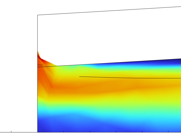

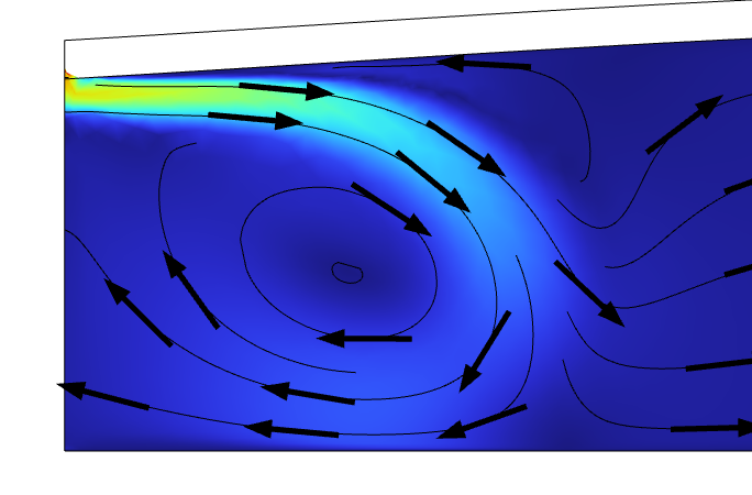

Hey Jeff, thank you very much for you answer! I tried to prescribe the left edge aswell however this leads to wrong results during the simulation and after a short period to an error where the Nonlinear solver does not converge.
I attached two images to show what I'm referring to. I hope you can see that the solid material overlaps with the fluid domain and somehow a flow starts to form in the solid domain.
Do I need to specify something in the Fluid module for it to understand that there are changes of size at the inlet aswell?
