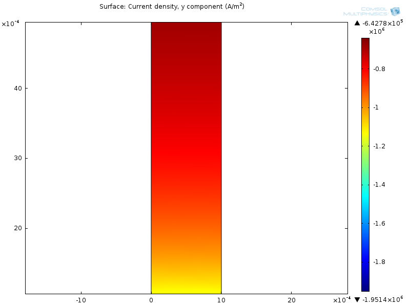

Dear Sergei, have you tried plotting the current distribution? I think you will find the results interesting. I have attached a figure of the current distribution of the Jaegel/comsol guide thermoleg simulated with your physics.
I'm interested in how one should choose testfunctions for the weak equations in one physics interface with dependent variables. Using the method with weak contributions the one in the heat transfer interface tests for its own variable T and in electric currents use V. But in the physics guide I cant find any reason for that one variable should test one and not the other weak equation.
q·test(∇T)+Q·test(T)
-J·test(∇V)
Why not:
q·test(∇V)+Q·test(V)
-J·test(∇T)
The same goes for boundary conditions
qin*test(T)
Jin*test(V)

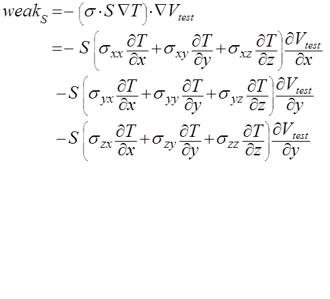

Jonatan,
Attached contains derivation of the thermoelectric weak contributions. Hopefully, this will answer your question.
Sergei

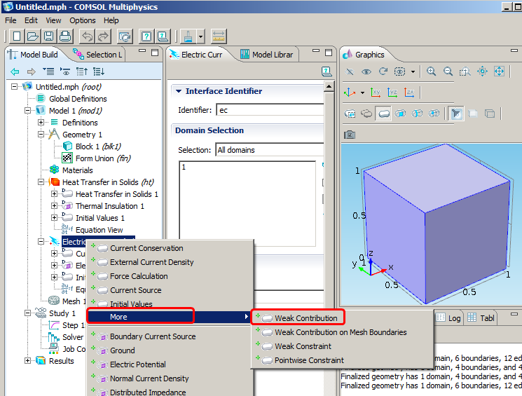

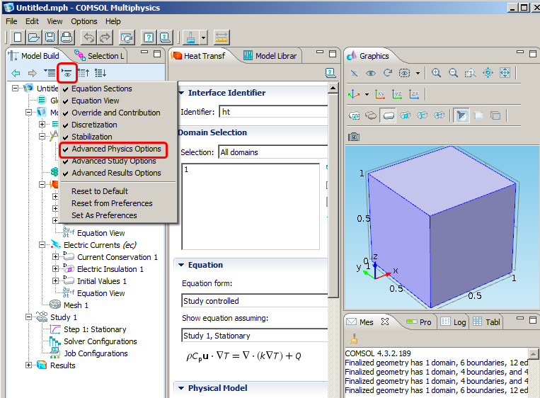

Dear Sergei,
A couple of weeks ago you sent me a copy of the Seebeck effect file for comsol v4.2a, and I am trying to make it work in a 3D environment.
may I know how did you add the 'weak equation' under the Electric Current tab or how should I add a 'weak equation' under that tab? Because right clicking the tab, I couldn't find 'weak equation' under the list.
Thank you in advance!

Dear Jonathan,
Could you tell me how did you add the weak equation to your 3D model? or How did you make it work in a 3D model?
Thank you!
Ying
[QUOTE]
Thank you so much Sergei, yesterday I managed to do it by myself in 2D axyal symmetric and 3D thanks to the pdf file you have attached. With the 3D model I make a comparison with my previous model in PDE form obtaining exactly the same result. Now I can also check if i did it correctly the 2D model.
[/QUOTE]
Dear Jonathan,
Thank you!
Ying
Sergei Yushanov
Certified Consultant
Posted:
1 decade ago
2013/10/09 11:18 GMT-4
Ying,
To add ‘weak equation’ under the Electric Current node:
Right-click Electric Currents (ec) node and select More>Weak Contribution under domain features list (top section above the line)
Sergei

Dear Sergei,
It seems that there is no 'more' option when a 3D domain is used. Is there any other way to add the weak equations?
Thank you!
Ying
Dear Sergei,
Thank you!
Ying
Sergei Yushanov
Posted:
1 decade ago
2013/10/09 16:19 GMT-4
Ying,
To see "More/Weak Contribution" you have to activate “Advanced Physics Options” under “Show” button – see attached images.
Sergei
Ying,
Sergei
Posted:
1 decade ago
2013/10/09 16:28 GMT-4
Dear Sergei,
Thank you very much! It's working now :D
Ying
Dear Sergei,
Ying

Seebeck weak contribution is placed for current balance, "emdc" interface, in your case.
This term is shown in the attached image.
There are couple issues with your weak contribution expression:
1. According to Comsol sign convention, Seebeck weak term should be with “minus” sign.
2. Seems you are modeling material with isotropic electric conductivity: sigma_xx=sigma_yy=sigma_zz=sigma. Then, all off-diagonal terms for electric conductivity should be zero. Yet, those terms (containing sigma_xy, sigma_xz, etc.) are non-zero in your expression.
Sergei
Dario,
Sergei

Posted:
1 decade ago
2014/04/17 16:03 GMT-4
Dear Jonatan,
How did you get the current density? Now what I have is voltage but I need current density to calculate the power generation.
Thanks!
Junce
Dear Jonatan,
Thanks!
Junce
Posted:
1 decade ago
2014/04/18 10:40 GMT-4
Are you using the physics builder guide method?
To meassure at boundrary, create a boundrary probe and use the insert or replace button in the expression section and find your identifier.Jx Jy or Jz from the drop down tree, choose your used physics then current density. To get current, change the type in the probe setting section to Integral. I write the expressions in variables with aproriate names then export the results to tables through global variable probes to get tables with nice headers.

I think the only difference is that in 3.3b we use the features called generic feature, domain conidtion or boundrary condition instead of just feature as in the 3.3guide.
I used domain condition for the domain contition but genereic feature for the other condtions, where i choosed boundary in the supported geometric entity levels but you could use boundrary condtition directly, it should be the same thing.
Since the seebeck effect does not readily exist as a material parameter I have the material parameters deactivated and use user input instead as in the guide. Do not use material parameters in model mode but instead variables and for selected domains.
The deactivated weak form equations 3 and 4 is never used since for real materials the seebeck effeckt is always much lower then the conductivity.
I think the attached file will work in your version. It can be tricky to successfully get the interface to the physics area but i think its good to locate the physics builder manager from the view dropdown and press the register development files button in the upper right corner of the manager.

I know it is an old post but I was hoping you could help me out.
I'm new with Comsol and I'm trying to test the Seebeck coefficient in Copper. I simulated a of copper wire on a FR4 and set one side of the wire to 10 K and the other end of the wire at 400 K, one end is grounded, the other is not connected anywhere as I want to measure the open circuit voltage. I added the Seebeck coefficient of the copper to its list of the coefficient and put the right number for it. The problem is that I can't see any voltage. I wonder if you could help me with that.
Thanks!
Thanks!
