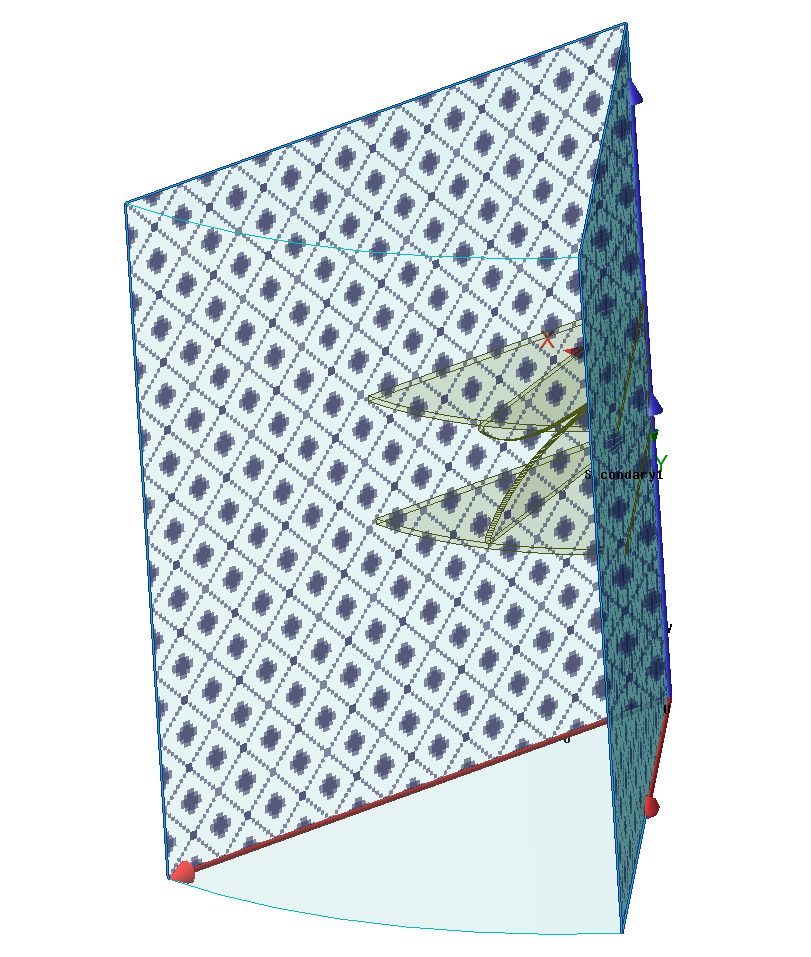

I was wondering if COMSOL RF module supports Cylindrical Periodic Boundary Conditions. For now, I know only the HFSS solver to do that. If Comsol or ANY other Electromagnetic solver do that please advise.
Please see image attached ofr better illustrate the question
Thank you

I think the Periodic BC should be what you want.
Cheers Edgar
