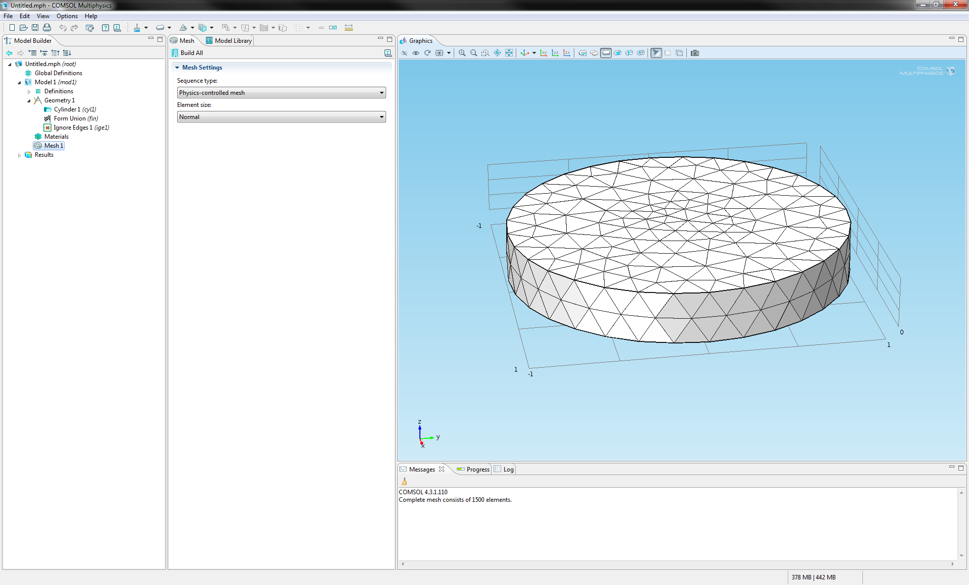

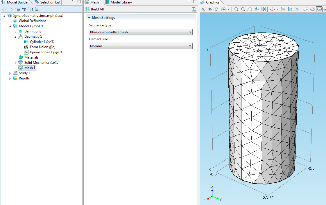

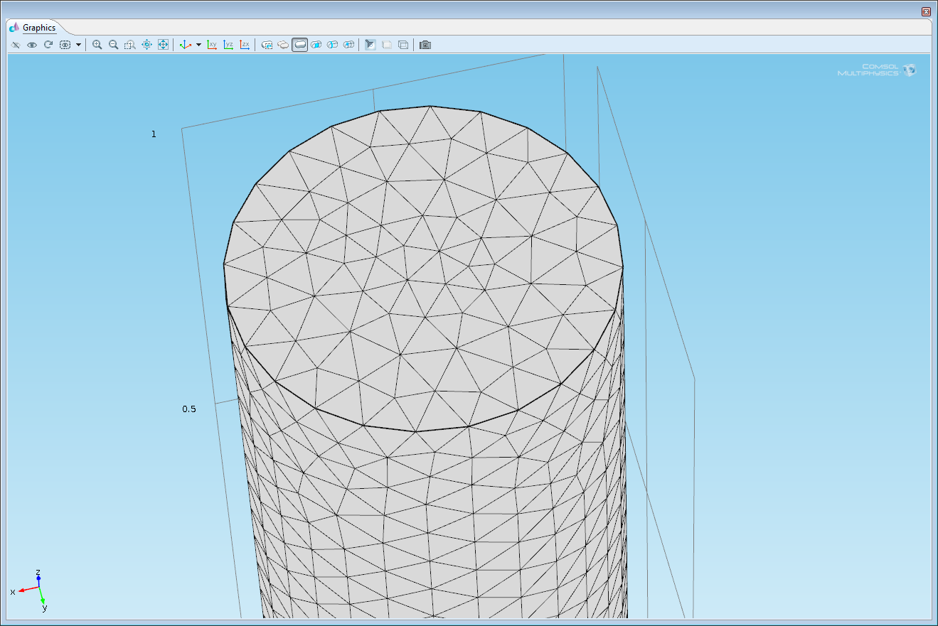

I don't know if Blair is saying it in the last message, but I get rid of the lines if I ignore BOTH the vertices AND the edges of the cylinder. I send the image.

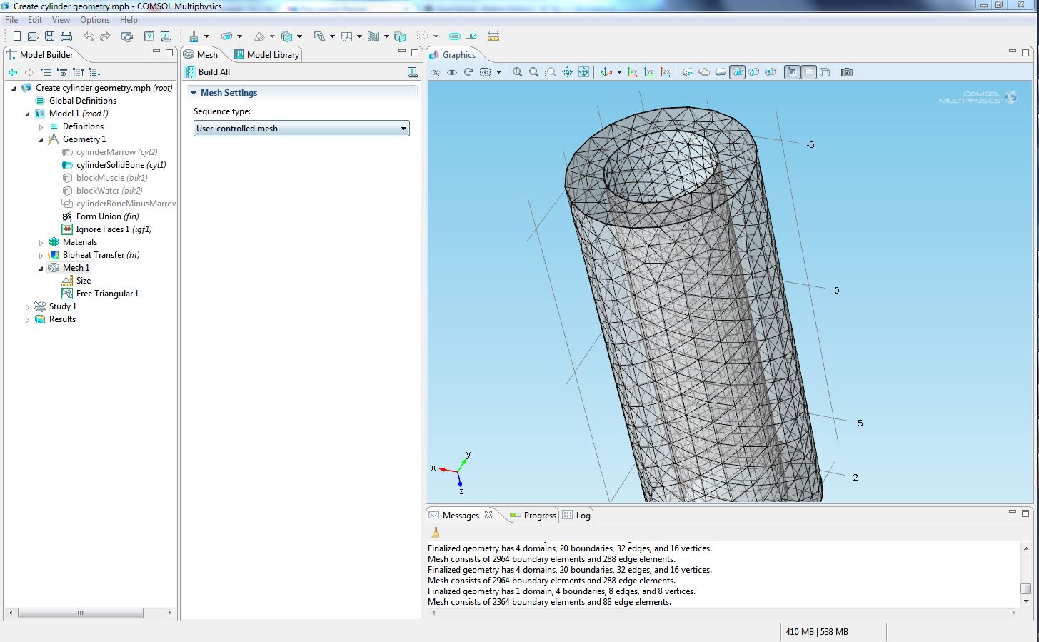

I stumbled upon this thread trying to create a hollow cylinder mesh in COMSOL.
Suffice to say all your help did not help, at least not for COMSOL 4.3b.
The way I did manage to mesh my hollow cylinder (as can be seen in the attached image) was by ignoring the inner faces while keeping the checkbox "ignore adjacent edges and vertices" checked.
COMSOL 4.3b solution:
geometry→right-click→virtual operations→ignore faces

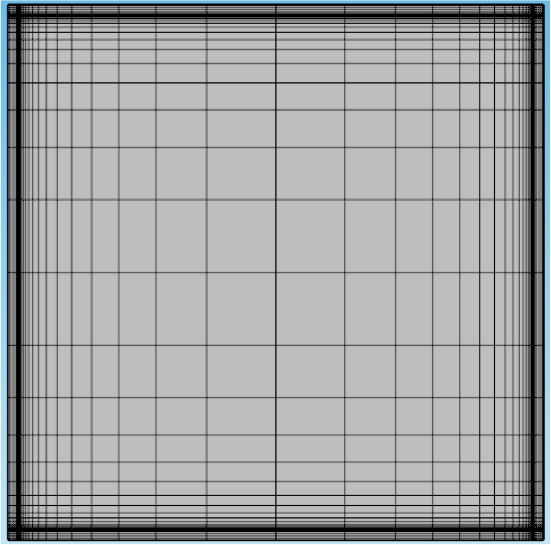

As you mentioned we can mesh on one surface and do sweep all the way to the one surface. However, I cannot find a way to mesh structured grid on the source surface which can be easily done on rectangular surface, please see attachment if you don't mind. In that picture, I have extremely fine mesh near the four walls (almost like black strips) where my boundaries locate.
So if I want to do the same thing for a pipe, extremely fine mesh near the walls, could I accomplish this task in comsol by any ways?

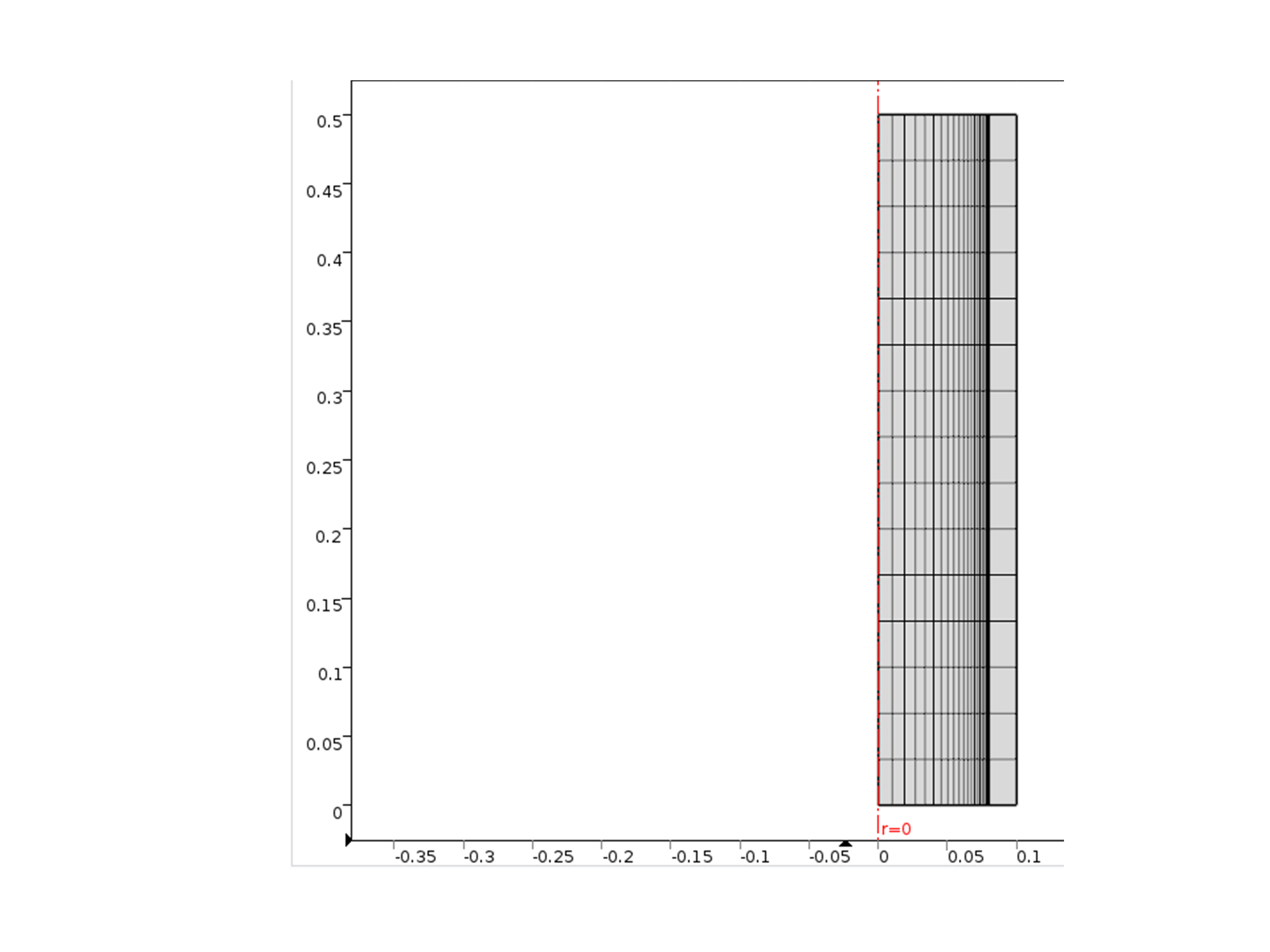

If you can use 2D axisymmetric model, it can be done with meshing first the top and bottom of lines with
Edge --> Distribution -->
and then mapped mesh in the pipe. See attached a suggestion.
