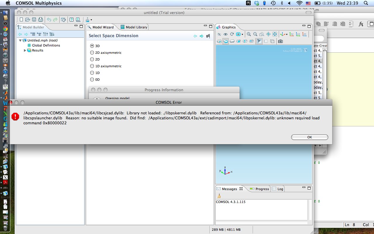

COMSOL 4.3a Installation Problem
After installing 4.3a, whenever I open most files (or try to at least), I get the following error in a pop-up window:

Let's start with what type of computer, what operating system, what version of the operating system, memory in your machine, and anything else you might know about your computer (graphics card. etc.).

The graphics screen is displayed in black color only.
whenever i open any model, the program turns off.
The graphics screen is displayed in black color only. whenever i open any model, the program turns off.

Posted: 9 years ago 2017/01/03 16:35 GMT-5
I have the same problem. I am a new user of COMSOL and recently installed COMSOL 5.2. I have a black screen on the Graphics page. Cannot draw anything. Can anyone help me on this.
OS: Windows 7 Enterprise
64 bit OS, IT, 32GB RAM
I have the same problem. I am a new user of COMSOL and recently installed COMSOL 5.2. I have a black screen on the Graphics page. Cannot draw anything. Can anyone help me on this. OS: Windows 7 Enterprise 64 bit OS, IT, 32GB RAM

Hello Srikanth,
Sounds like a typical graphics card problem. Please see the Support Knowledge Base for the solution: www.comsol.com/support/knowledgebase/933/
Hello Srikanth, Sounds like a typical graphics card problem. Please see the Support Knowledge Base for the solution: https://www.comsol.com/support/knowledgebase/933/ Best, Jeff
