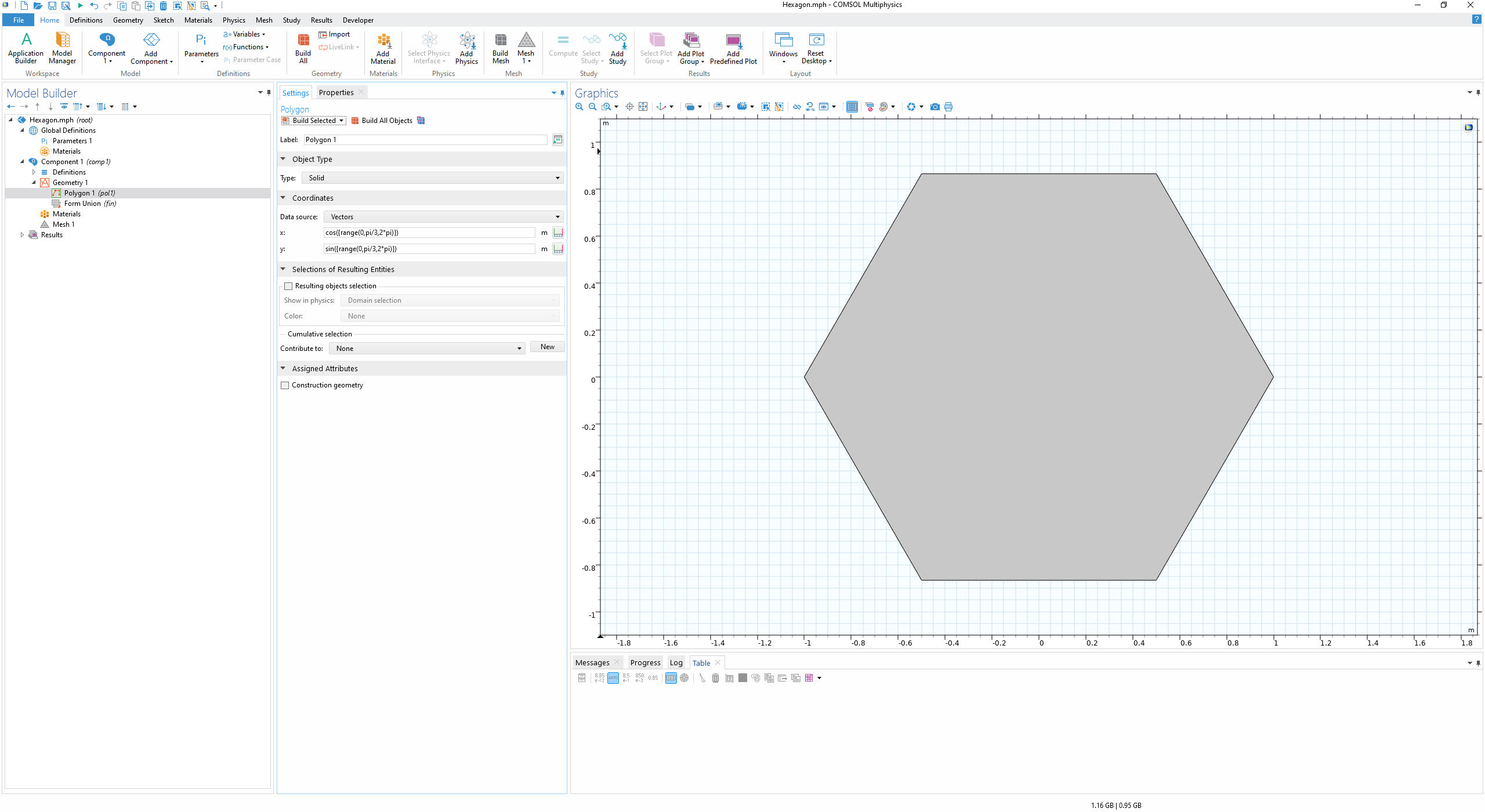

Hi again,
You will find the formulae in the file Hexagon.mph attached to my post in the thread I mentioned. In case you are unable to open that file, you can see them in the attached screenshot.
Jeff Hiller
Hi again, You will find the formulae in the file Hexagon.mph attached to my post in the thread I mentioned. In case you are unable to open that file, you can see them in the attached screenshot. Best, Jeff
