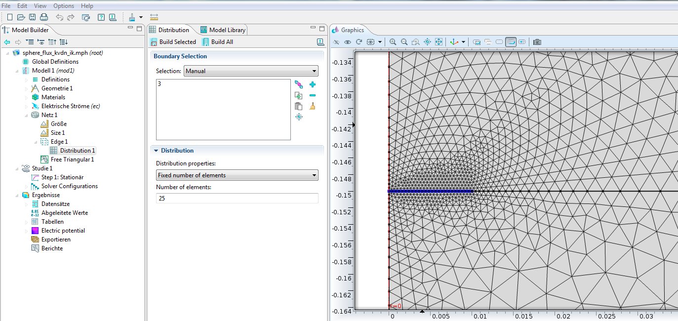

by playing a little with the mesh I get a current density (integrated over the 2*pi*r loop) of
Normal current density (A) GND Normal current density (A) Electric potential
-3.59484e-4 3.2505e-4
over the external sphere edge and the internal ring.
All with your 8e-6V potential, and a normal mesh on the external domain.
By further increasing the mesh along the Voltage edge I even get to 3.44e-4 (A) closer, still mesh sensitive
Now to get a far better Current value is to use a Terminal node,
then your Global evaluation - Terminal curent on the is 3.60202e-4 (A)
less than 1:3000 from the GND current with a fine mesh of -3.60346e-4 (A)
Have fun Comsoling
So if I understand correctly it is a problem with my mesh. The difference of the value of the depending variable (V) between neighboring nodes is too big?
So the mesh should be finer around the 'stimulation' electrode?
May I have your improved model so I can see what you precisely did?
2 things:
1) certainly the mesh, your source region is small and you need several mesh elements along the edge and in the direct vicinity to calculate correctly the Voltage drop, hence the electric field, and from there the current flowing.
2) you have Electric Potential and lumped Terminal type BC to define a voltage or a current source. The Lumped Terminal BC automatically adds local flux (current) variables, that are resolved with higher precision than for the Electric Potential BC node. The latter allows you hovever, to define a voltage as function of the boundry length/area, or some spatially (not only time) variable Voltage or current source. But with a less precise flux evaluation.
When I say less precise, it's with respect to a coarse mesh, with relly fine mesh you get almost to the same values.
Last thing, as I have said several timeson the Forum, (you are not the first ;): consider the mesh as a sampling method, for music people today understand Nyquist criteria, and you decide sample with reasonably hgih speed, to get a good quality sound, for meshing it's the same, apart that it is the depedent variables, and particularly their gradients you should look at, if the variables have high gradients, steep slopes, you need dense mesh to resolve correctly the shape, else you make a triangular short cut and your results will be easily wrong
