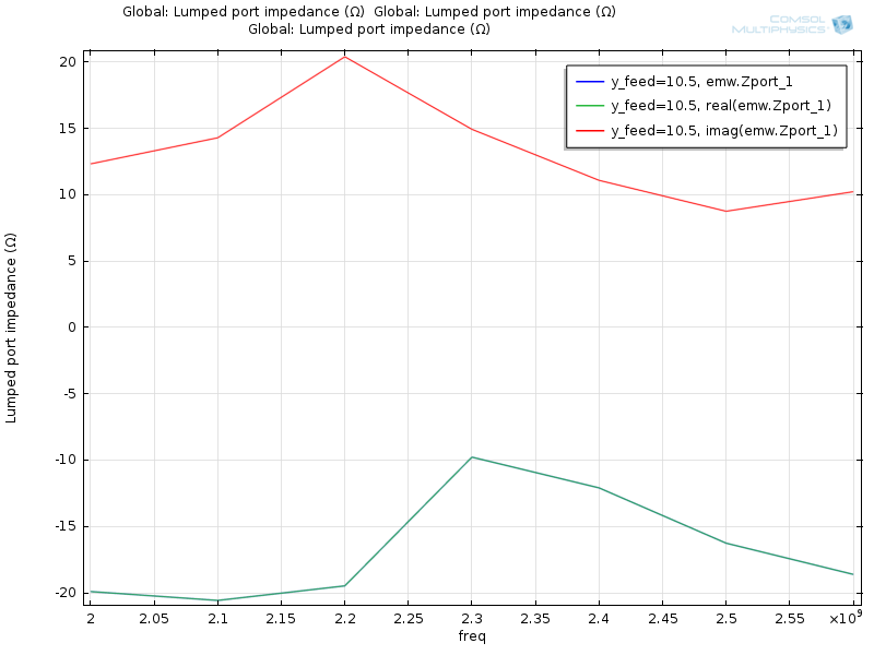

I used the global result emw.Zport_1. And things get even stranger when I look at the complex components. Here is what I sent to COMSOL support as well:
It looks like emw.Zport_1 actually returns a (wrong) real part only. One example at a specific frequency:
emw.Zport_1 = -10 Ohm
real(emw.Zport_1) = -10 Ohm
imag(emw.Zport_1) = +15 Ohm
emw.Zport_1 should be sqrt(real^2 + imag^2) = sqrt((-10)^2 + 15^2) = 18.02
Surprisingly the results are the same when I calculate the impedance and its complex components form emw.Vport_1 / emw.Iport_1.
According to the definition the absolute value of the imdedance cannot be negative and I always presumed that emw.Zport is defined as the absolute value of the impedance. I assume this is a bug in COMSOL.
I attach the impedance plot. Please note that the blue and the green line are on top of each other.
I appreciate your input.
Best regards
Edgar

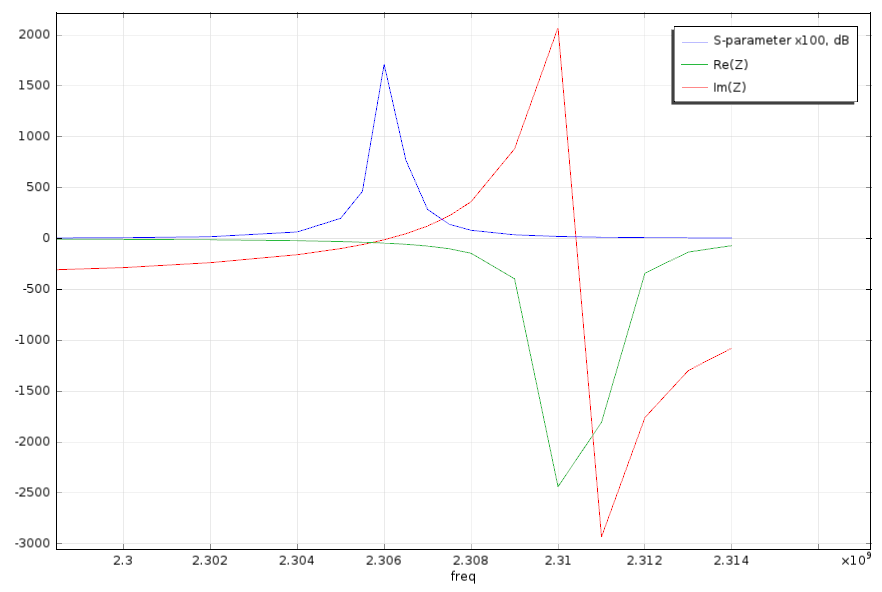

I'm experiencing the same problem simulating an Alderman-Grant-resonator at ~2.3GHz.
The imaginary part of the frequency-dependent impedance behaves as expected. The real part gives a symmetric peak, as expected, but with negative sign. Correspondingly, the S11 parameter shows a peak with positive values.
Could you tell me where to find that phase setting that solved the problem in your case?
Oliver
