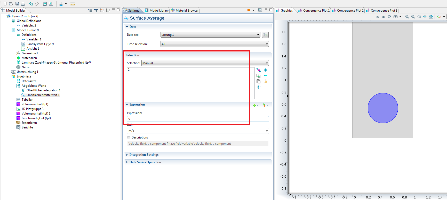

I am solving a two-phase system and I want to know, how can I calculate the time-dependent rise velocity of the bubble (in the file below)? In my case the domain selection is not possible because the solution is non-stationary.

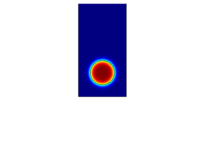

nice bubble ;) by the way you can make the border more precise if you reduce the color domain to i.e. 0.4-0.6

Yes, I need the volume of the bubble for calculating the (average) velocity. In the bubble the phase-field variable phi <0.
How can I define a global expression for the velocity depending on phase-field variable? Or how can I calculate the volume of the bubble?
v(phi<0)
In the COMSOL I can only select a surface (domain) and the expression like velocity or phase-field variable but I can not select the domain, where phi<0.

You can define an integration operator intop1() as Definition Operator integration, and select your full domain
Thendefine a local variable Definition - Variable Xg = intop1(Xg*(phi>0.1))/intop1(1) and so on.
If you have a variation in density you might want to consider this too.
Then one can pastprocess the Xg variable to get the time derivative, from a time stepping case (not sure it was all there in 4.2, exist in 4.3a)

I know how one can calculate the circumference. I added to data sets (results) a contour of phi=0. Then I did a line integration over this contour. But there is a small inconvenience, one have to select the time manually. Ivar, what would you say?

indeed, a good idea, provided your mesh is fine enough, it should be more precise than my integration way
