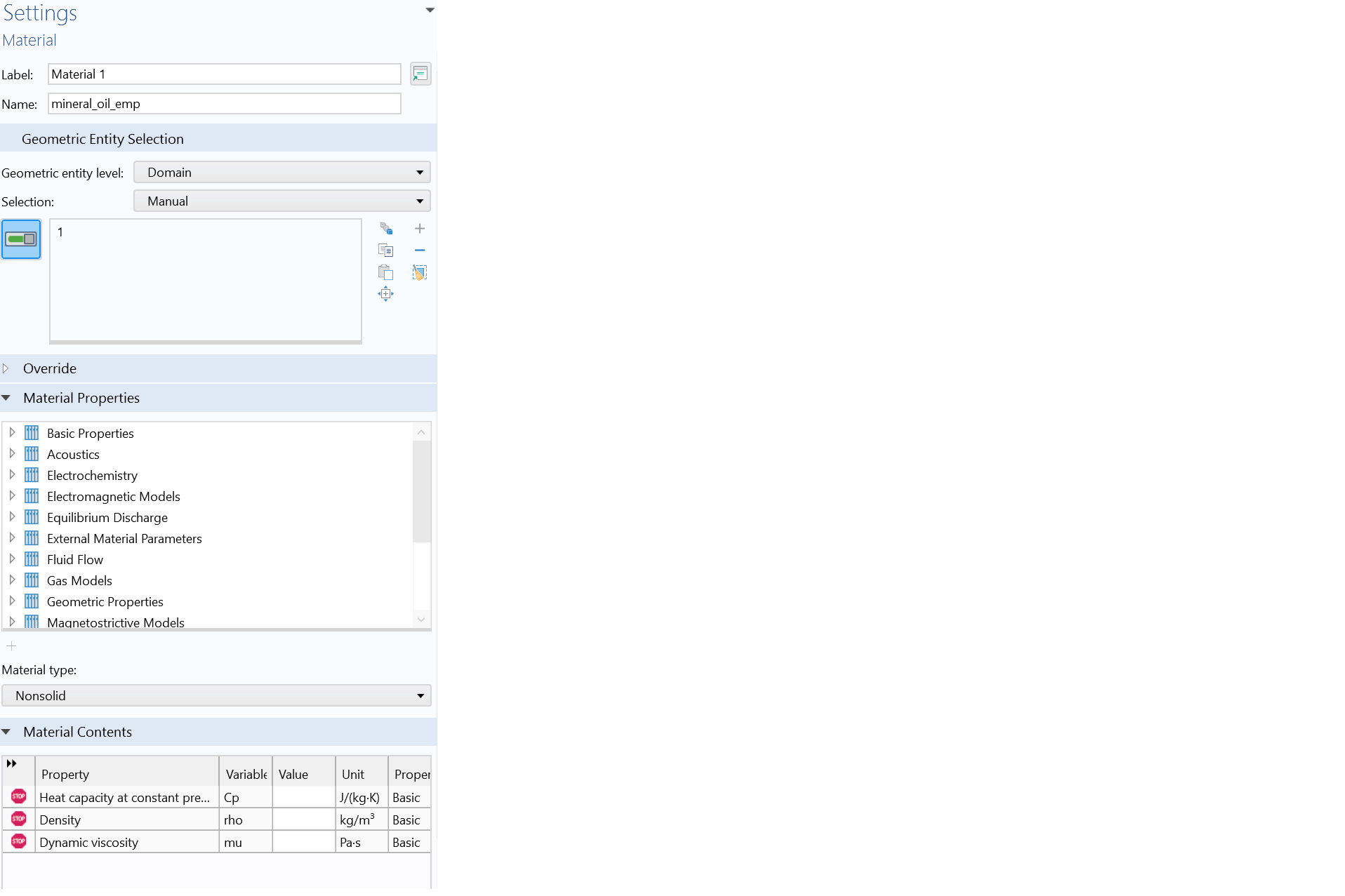

I am not able to get this model to run and get Warning message “MUMPS is switching to out-of-core mode”. Also get error message: Failed to find solution. Unable to read o write out-of-core file. I have tried different meshing (normal, fine and custom) but no luck in getting it to run. Could it be a meshing issue or something else.
Best regards, Richard P.S. Running Windows and COMSOL 6.1
