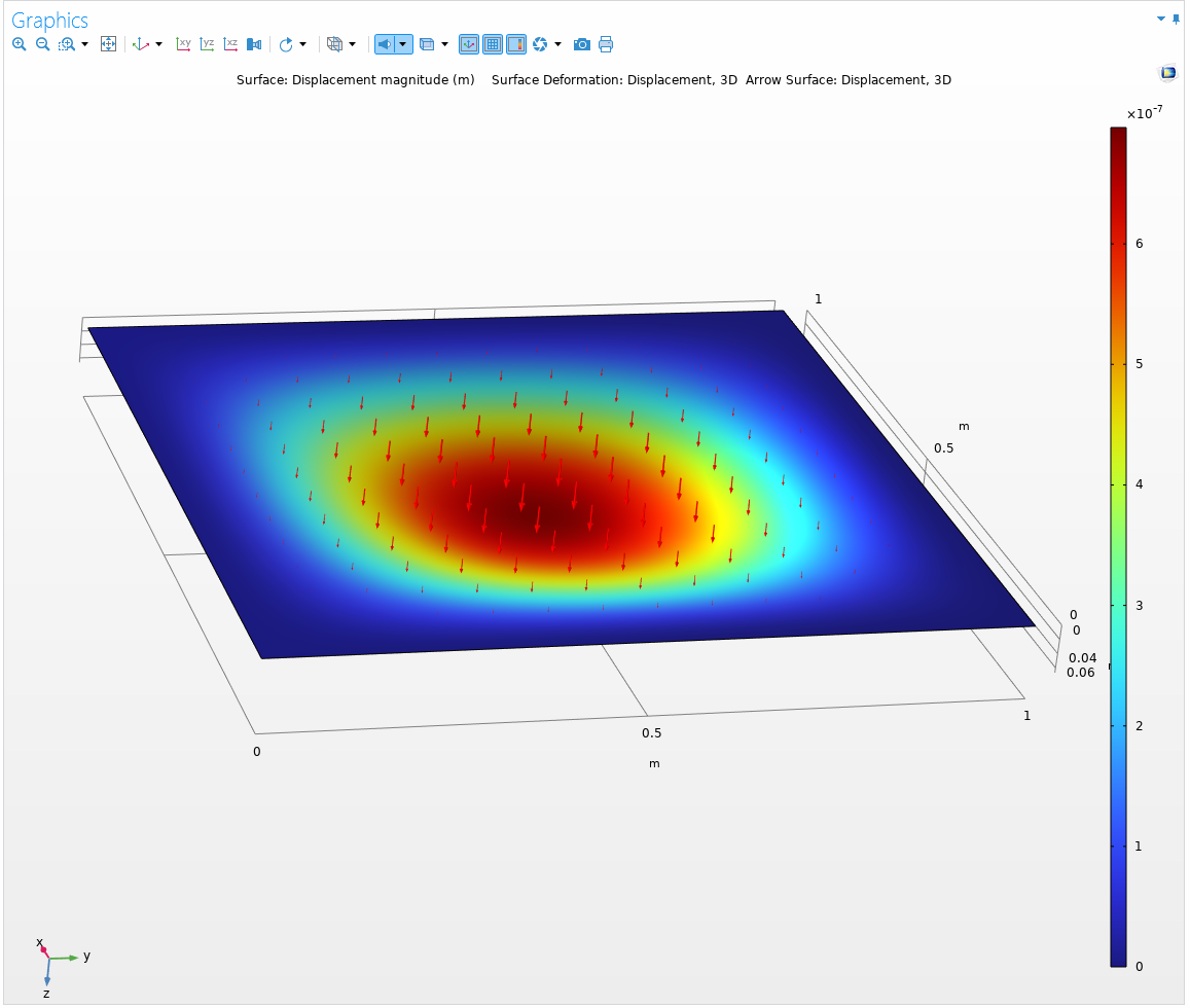

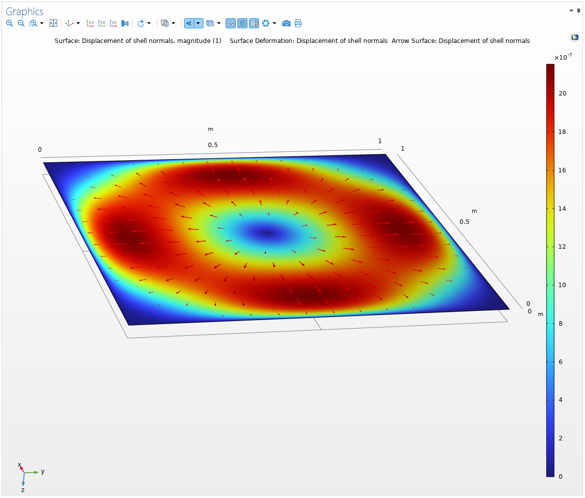

I am investigating the deformation of a square thin plate with four fixed sides subjected to a uniform load.
I modeled the thin plate using shell units and got the results at steady state.
The simulation results are in the attached file. Figure 1 shows the displacement and Figure 2 shows the normal displacement.
My problem is that the normal displacement doesn't seem to cause any surface deformation. And it is not pointing in a direction perpendicular to the sheet.
What is the difference between normal displacement and displacement?
Thank you for your help.

The variable named Displacement of shell normals ( not Normal displacement ) is a quantity measuring the rotation (in terms of displacement of tip of normal vector). It is the rotational degree of freedom in the shell formulation. Please refer to the theory section in the Shell chapter for more details.

If Displacement of shell normals doesn't mean Normal displacement, then where can I find Normal displacement?
I need the displacement perpendicular to the initial shell surface, but I can't find the variable Normal displacement in the results.

I think to produce the plot you want, you simply need to create a plot of u, v or w (depending on whether your normal direction is the global x, y or z direction respectively... looks like z from the attachment above, in which case plot w).
Be sure to enable a displacement node under your plot so that you can see the physical displacement, (you can scale this displacement to achieve the desired graphical result).

For simple cases, for example when the shell is flat in the XY-plane, then the easiest is to just plot the displacement in the Z-direction (w).
But for a general curved shell, you have to plot the dot product between the displacement field and the shell normal. Either you create it manually using an expression like shell.anX*u+shell.anY*v+shell.anZ*w, or you create a transformed displacement vector using Definitions -> Variable Utilities -> Vector Transform.
