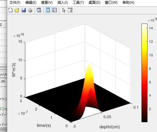

I want to import the f(x,y) function computed in MATLAB into COMSOL, I don't know which function to use The data I got with MATLAB is discretized, the variables x,y are 601x1 matrices, f(x,y) is the 601x601 matrix, I don't know which function to use to import this three-dimensional discrete data into COMSOL. Best regards!
The function shape is in the file.

mphinterpolationfile should be a good place to start.

...and if you want to do it from the GUI, use Interpolation Functions. They have been discussed many time in this Discussion Forum.
