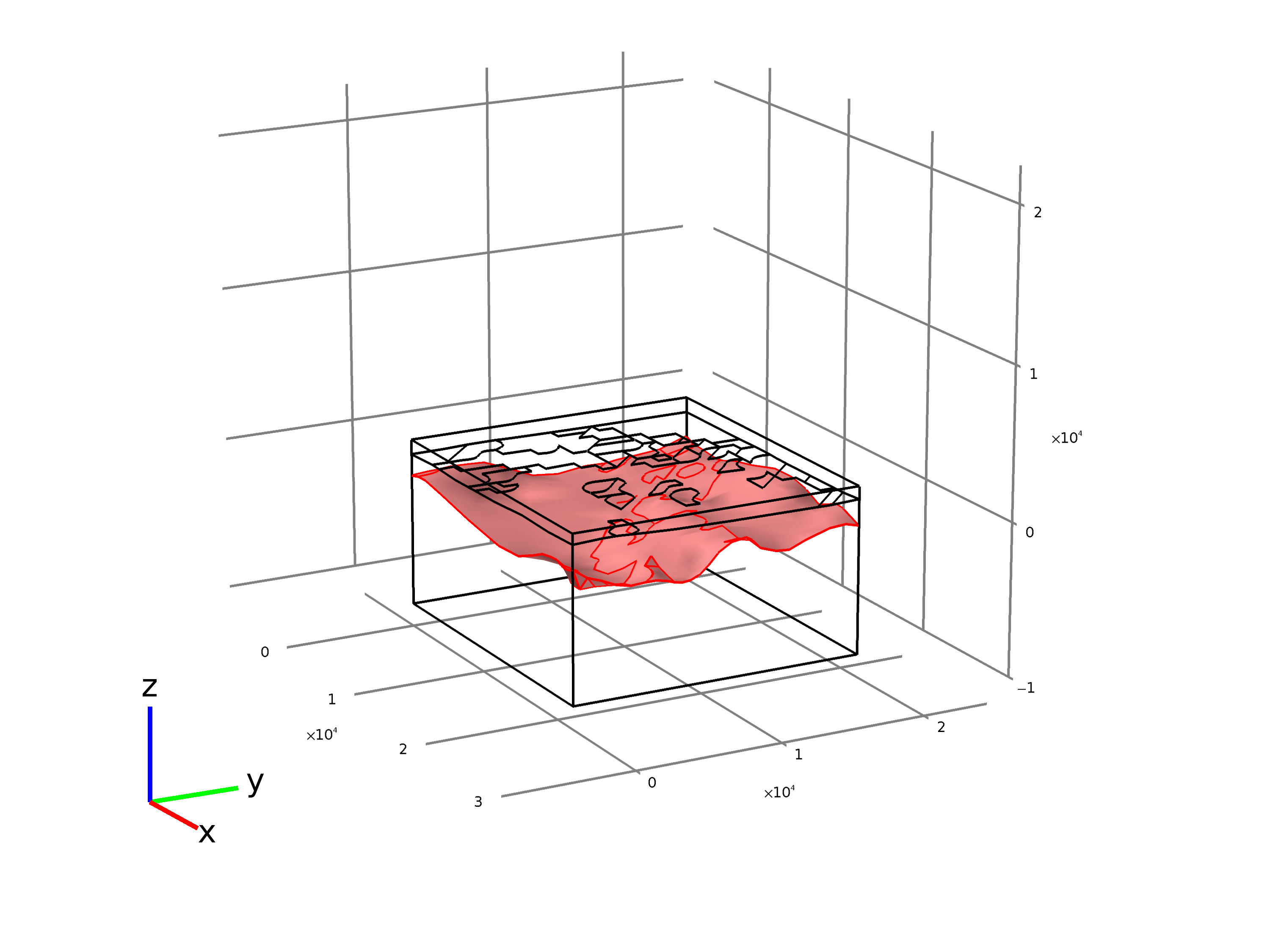

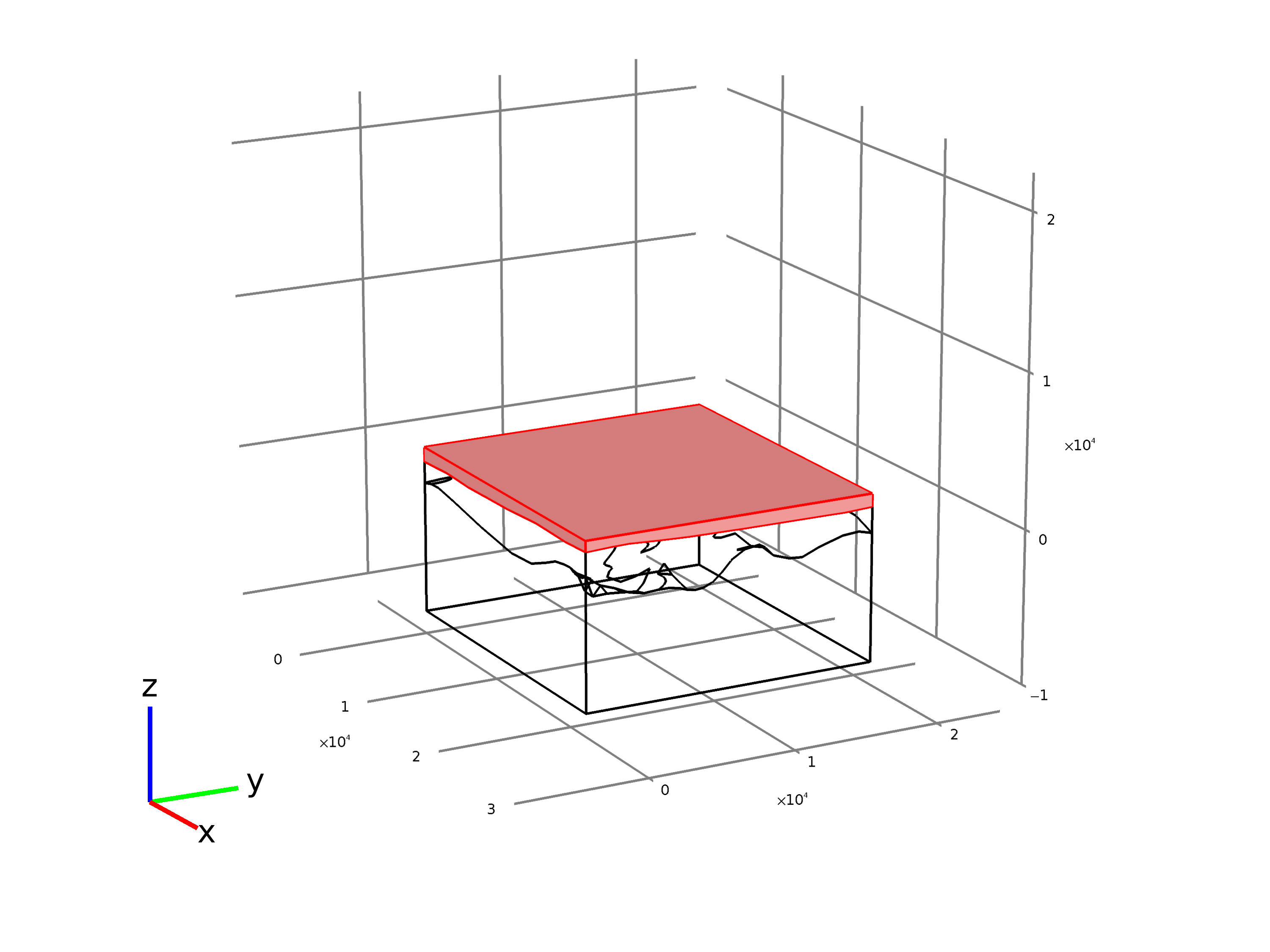

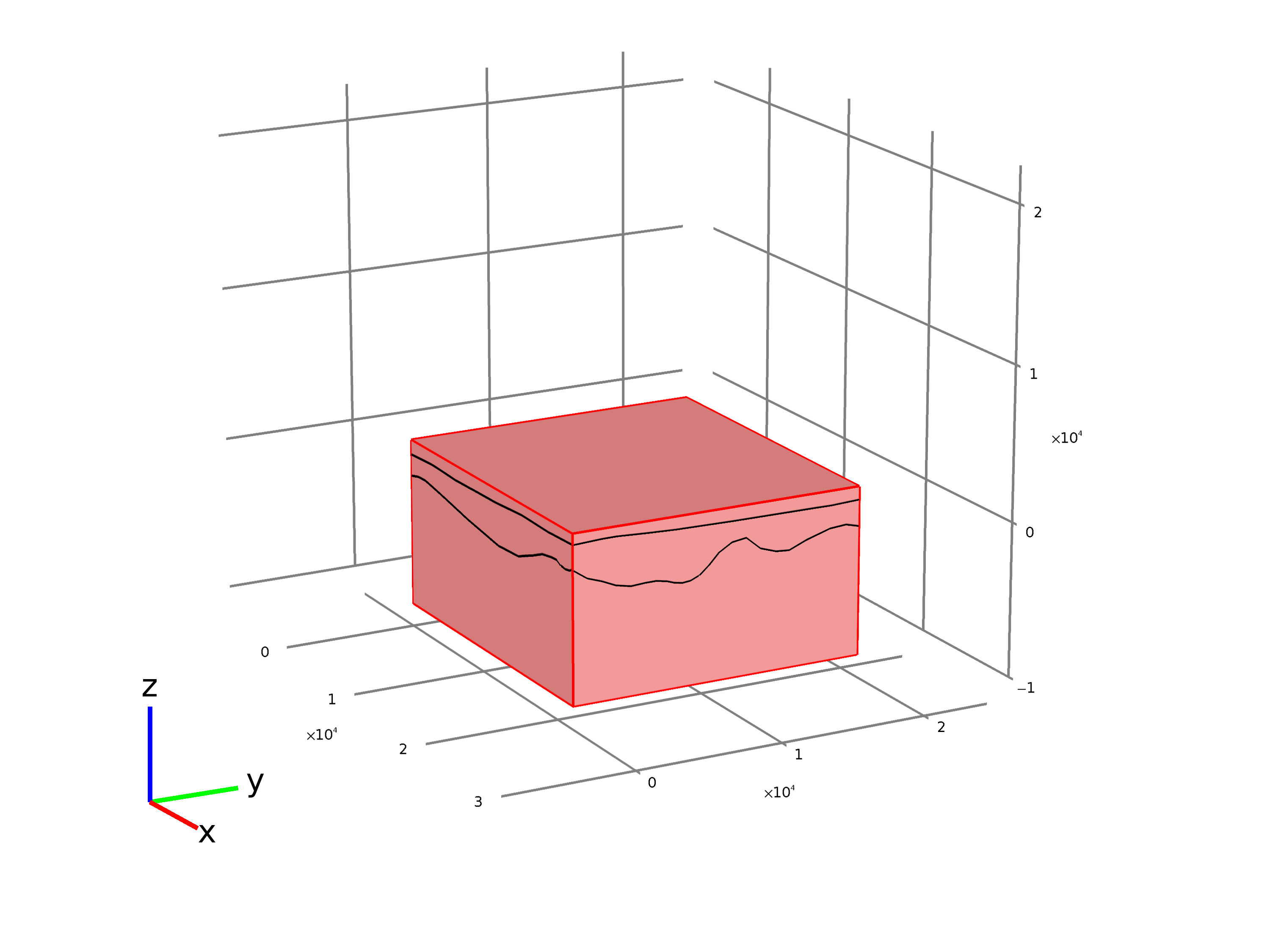

I imported two objects as .stl files: the topographic surface-imp1 (see figure topo.png) and the top of a geological unit-imp2 (see figure top.png). Finally, I added a block-blk1 (see figure vol.png) that fits the previous surfaces and it delimits the volume within wich I would simulate the heat transfer process.

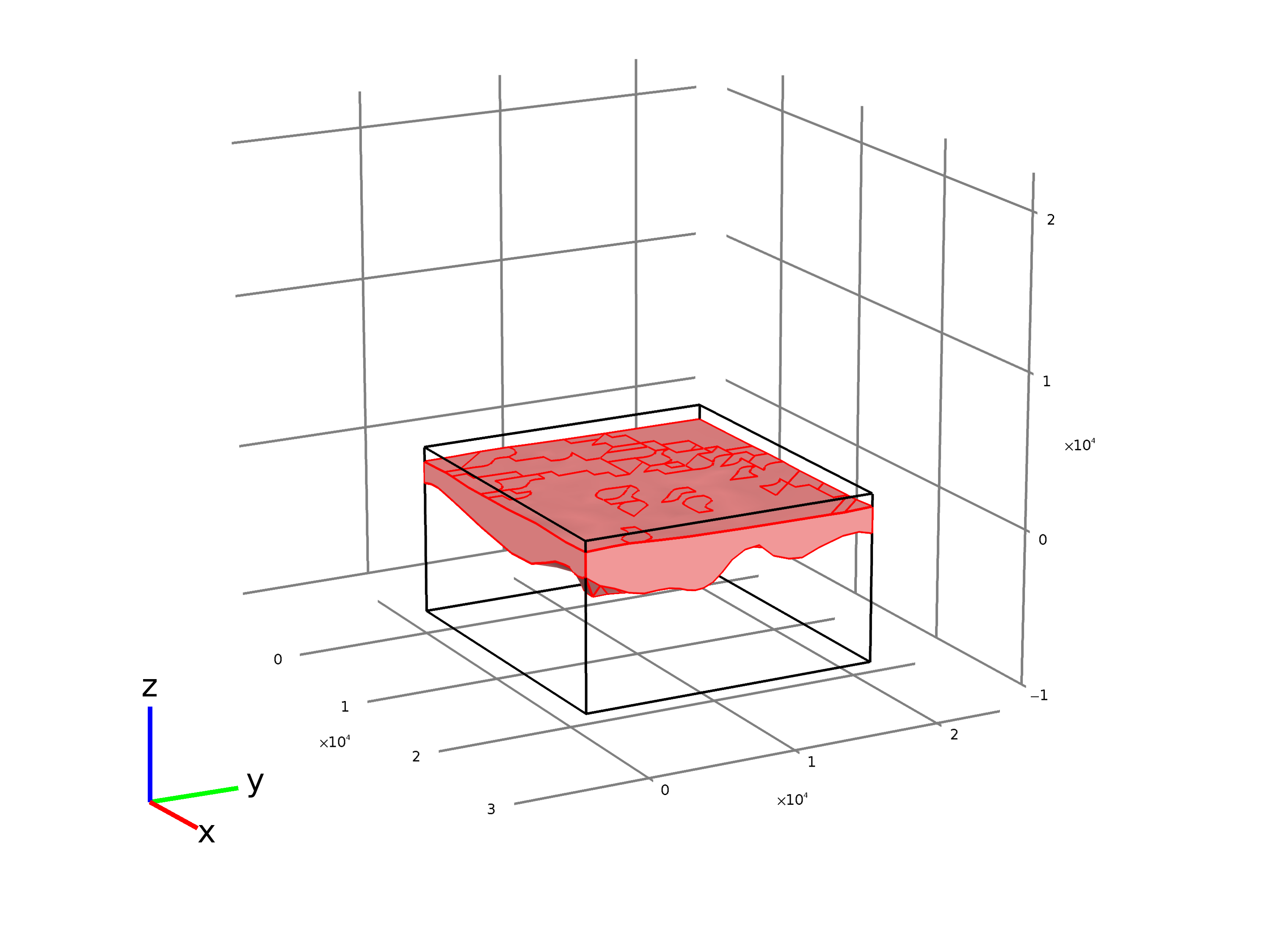

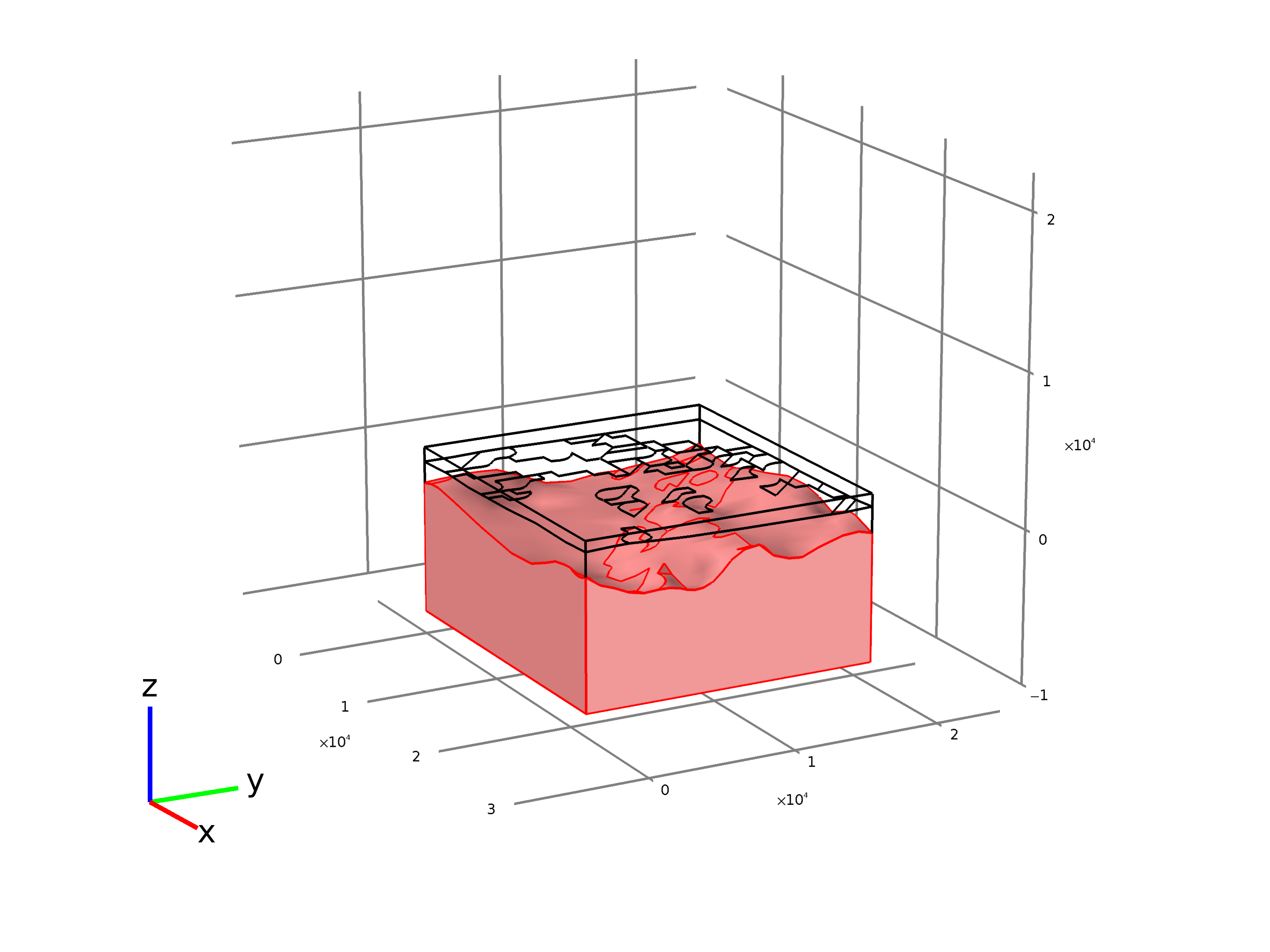

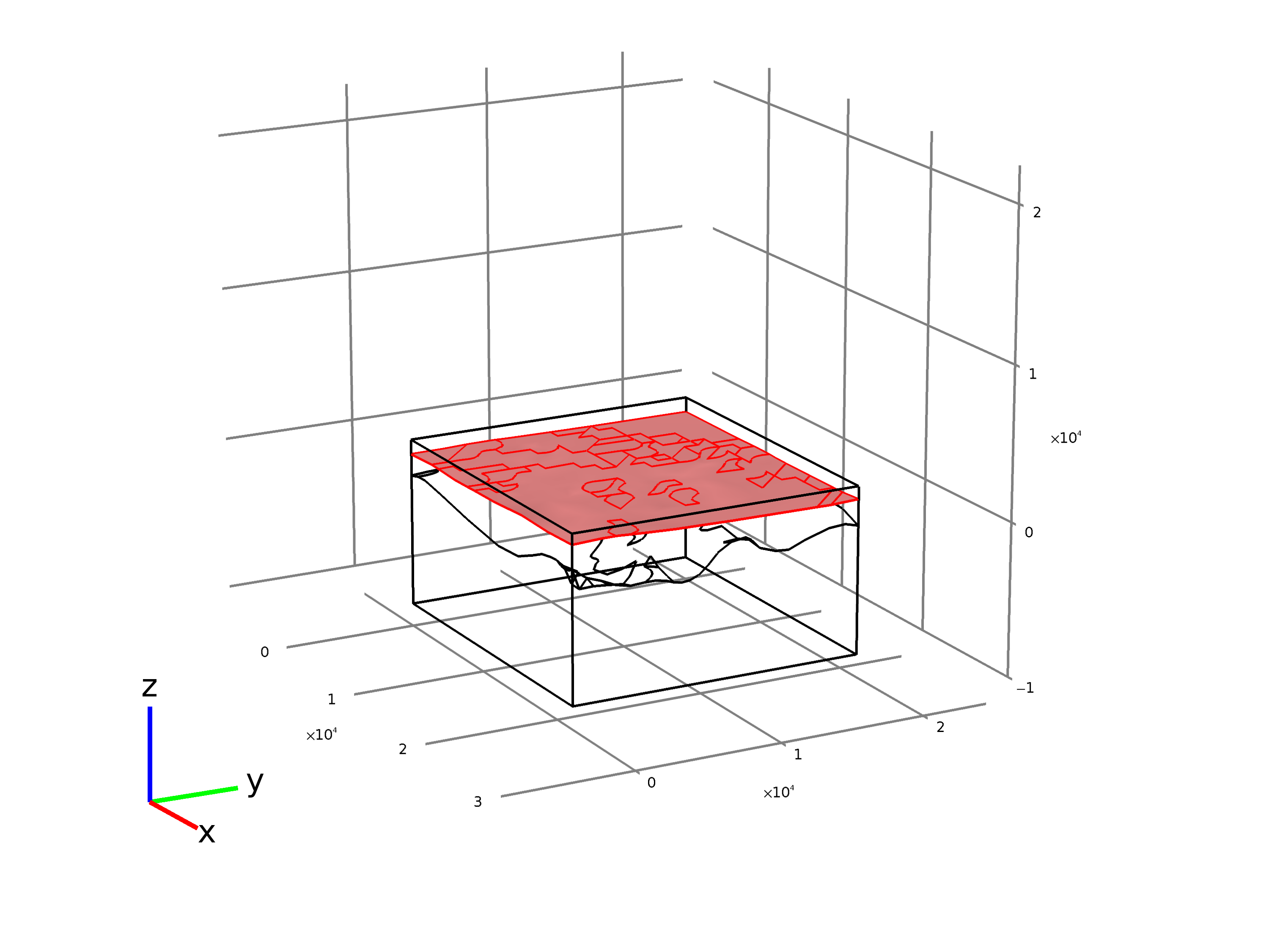

In Model / Definitions I can see the three (automatically) recognized domains: the first rapresents the reservoir (res.png), the second the cap rock (cap.png) and I would delete the third one (del.png), as the topographic surface has to be the top of the model.
I have to generate two solid corresponding to res and cap domains, how can do it?
