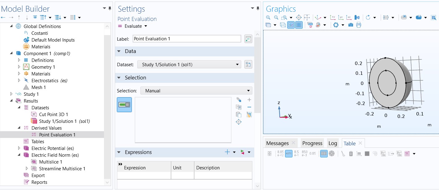

Hello everyone, I create a cut point 3D at the point (0,0,0), but when I try to select the point in the section Point evaluation, the point is not visible. How can I select that point?
Select "Cut Point 3D 1" as the Dataset for your Point Evaluation 1..

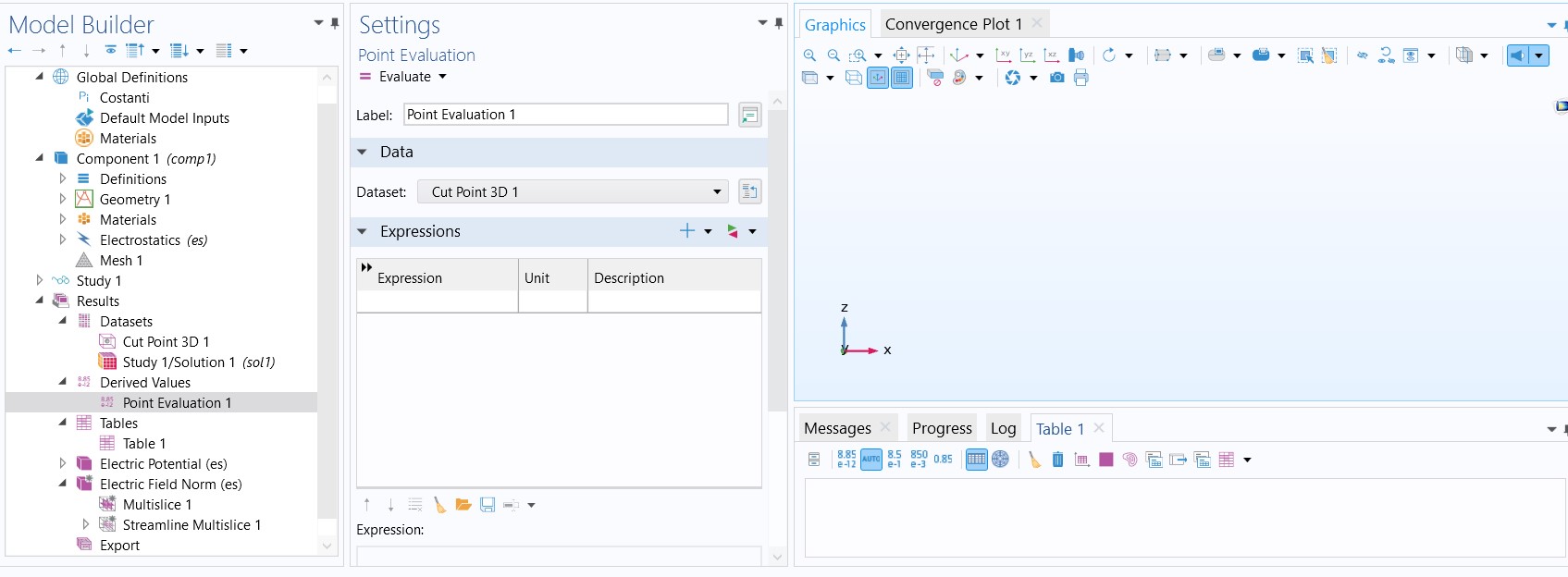

Thank you for the suggestion @JeffHiller I tried and I've some difficult to see the point; I clicked on evaluate, then I selected the point evaluation 1 from the electric field section.
Immagine 2023-10-20 144901.jpg : In your Point Evaluation 1 you have not specified what quantity you want to evaluate.

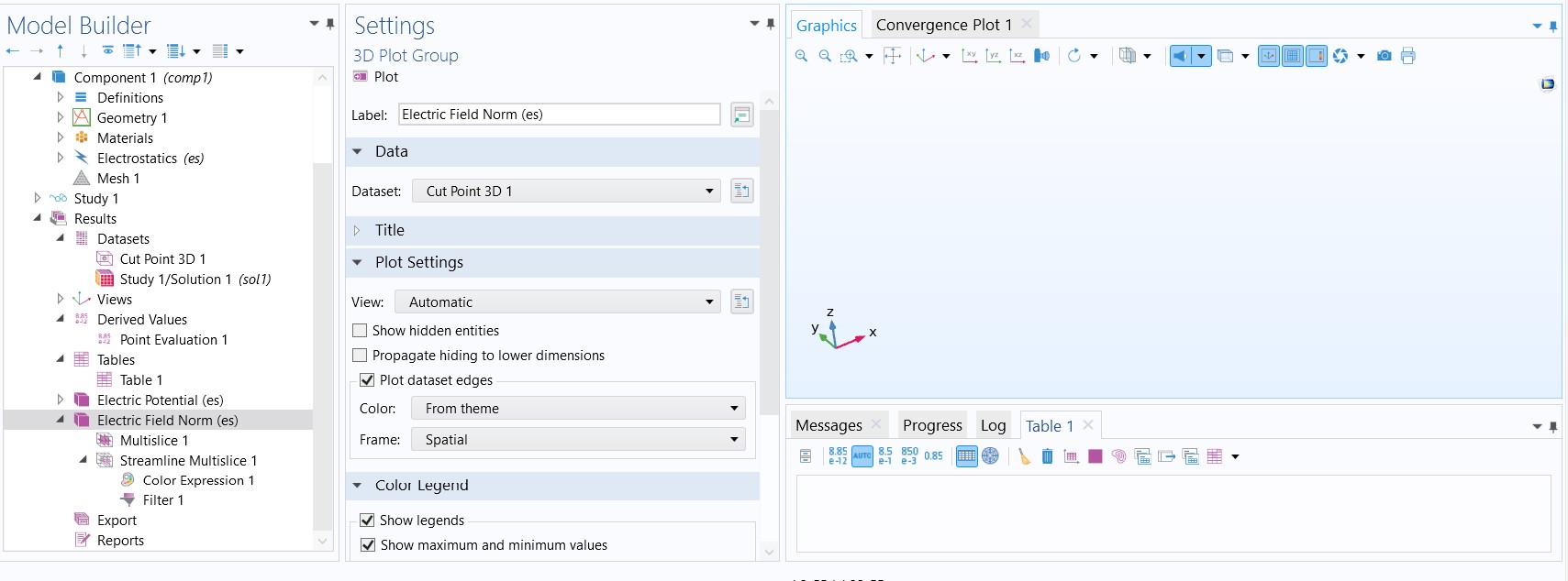

Immagine 2023-10-20 145036.jpg What you did in this screenshot does not make sense to me: you set things up to plot multislices and streamlines, neither of which can live in a point, so why select Cup Point 1 as the dataset?
PS: If you have not worked much with datasets and would rather not learn about them at this point, you could add the point in the Geometry branch, then re-solve the model. Then that point would be available for selection in post processing.
-------------------Jeff Hiller
Perfect @JeffHiller; the first method works.

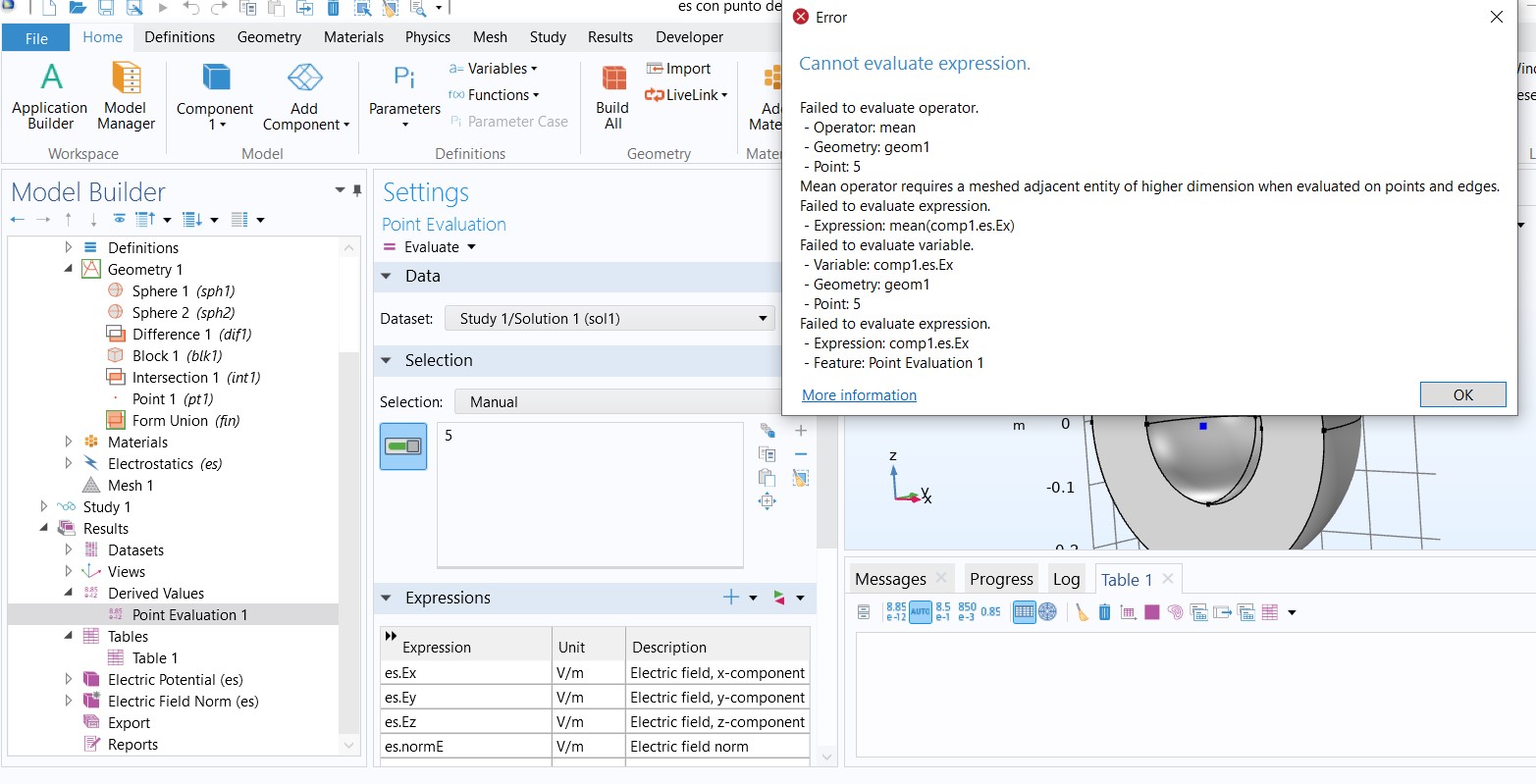

I tried also the second one, and I get the error in figure. Is this due to the fact that there isn't material between the object and the point?
Your latest screenshot suggests that the point is outside the computational domain, and, if so, I don't know what you could want to evaluate there.
